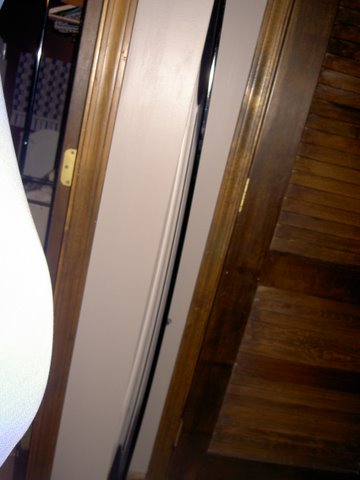

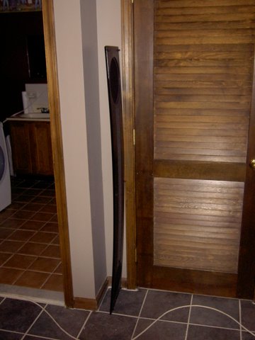

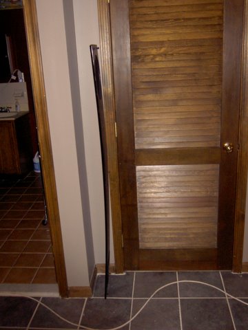

« Reply #7 on: 6 Mar 2008, 01:55 pm »
Here are the pictures of the warped waveguides:
It appears I'm going to have to reorder the waveguides.
