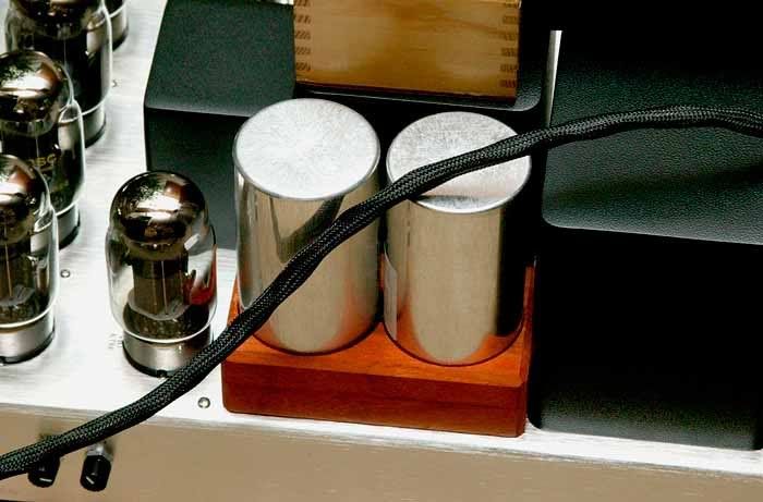

    Need more power for my Magnepans, thinking about monoblocks.  This amp has brilliant clarity and detail, 2 years old, fully modded. Checked out by Bill Baker last year with flying colors.
   Comes with new matched quad of Sovtek 6550 (55 watt), low hour matched ShuGuang KT-88 (60w), and matched quad EH EL-34's (50W).  Pix on request.  Pristine condition with 3 aluminum cone feet.
   $1350-OBO or  ??trade on 100-120W/ch tube amp.
