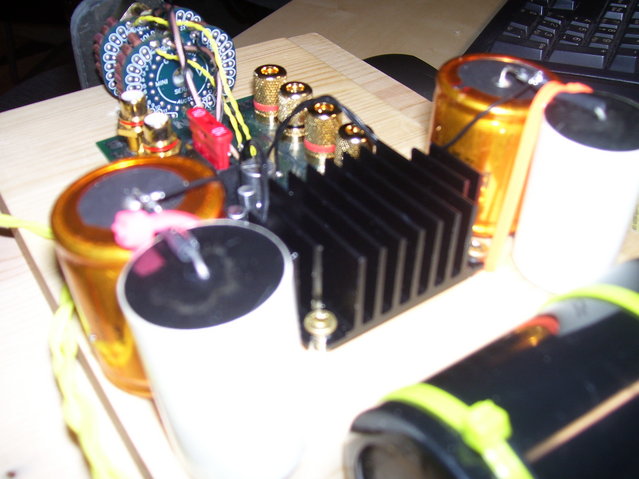

I have replaced the stock heatsink with this one:
Mouser part #567-547-95AB  Wakefield DC/DC Conv QUARTER BRICK VERT.    $9.95
The chip's thermal protection is effective, and it will kick in quickly in when the chip gets hot. The heatsink is a noticeable improvement, the amp doesn't clip as quickly as with stock heatsink which doesn't touch the hot part of the chip. It runs much cooler now, so I hope it will last longer.
Pics in my gallery:
Rich
Yes it is absolutely true. Thanks Rich for your help. I think it is a remarkable tweak and would make my music more resolution.  :thumb: :thumb: :thumb:

It is all about DIY. As I know the previous Attraction DAC's owner is medical equipment's engineer and he did the modifying. Basically he just removed the wima coupling caps, filter caps and relay in the stock DAC. Then he got the ASC oil caps 100mF/375V to put in the place of the wima. He also added to the spruce board with a plywood (painted black in picture) and three BRD cones to hold the huge ASC caps and the original DAC.
My parts I modded are two Mundorf Silver/Oil 0.1mF/800V to bypass the ASC oil caps and a Jensen electrolytic 10,000mF/25V to bypass the 12VDC PS from battery using as a booster and filter. And I modded my BYOB amp from the stock one. Any questions I will be happy to answer.

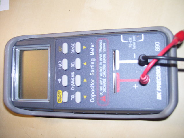

Is there any way to measure the parts with erased info?
Was it erased mF or voltage? if mF then you need a capacitor sorting meter like this one:
Tan
