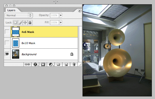

« Reply #2 on: 23 Jan 2008, 04:35 pm »
Wait, maybe I misunderstood.  The layer part is confusing me.  So you want a single document, but with just a layer showing a different crop?  I guess you would use the marquee tool with an aspect ratio constraint on it and make regular layers on top of the stack filled with a solid color like white or black.  This would just visually mask off the image.  Like so:
