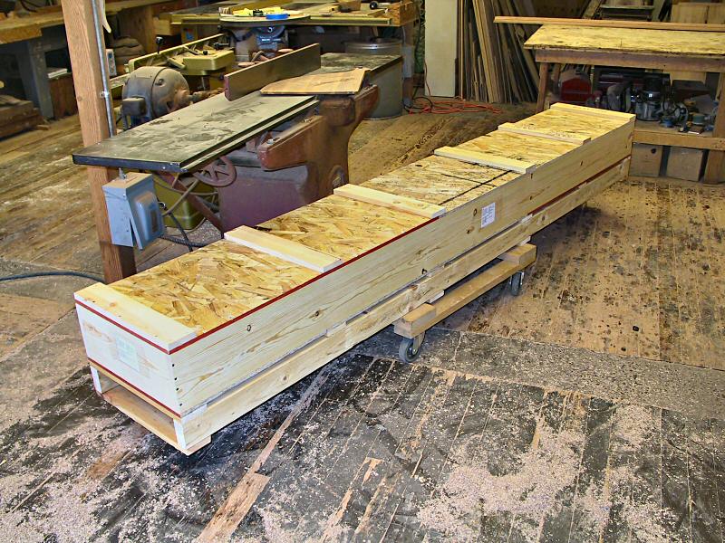

Yep, a large palletized crate with 2" of foam on all sides seems to work. I use 1/2" OSB for the top and bottom, 3/4" thick 1x4 and 1x10 pine for the sides with 2x4 skids attached on the bottom. Trucking companies have insurance limits, so you may need to buy supplemental insurance so you are fully covered. Order a lift bed truck if you don't have a fork lift handy, the driver will appreciate it. My crates weigh an average of 150 lbs. each before anything is added. Bubble wrap or peanuts plus 2" foam will absorb any shock if dropped, but make sure everything is well packed so it is tight and not able to shift, I also use a foam wrap so nothing gets scratched, my customers are very picky. Here are a couple of ideas to get you started.
Wayne
