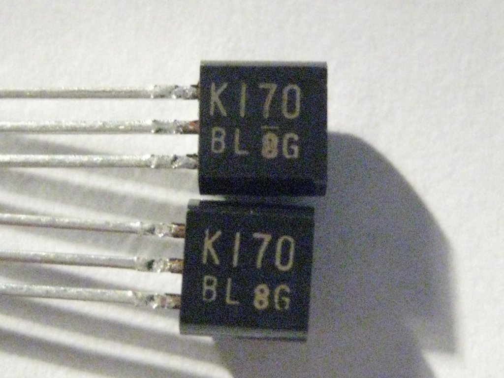

MATCHED/UNMATCHED FETS
You will need 4x matched 2SK170BLs per the BOM.
Or you can order bulk from someplace like Ampslab and use the DMM measurement setup
to match Idss.
You will want 6mA or higher.
This will be explained later.

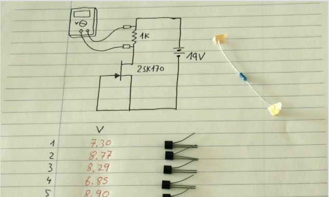

Hi Wushuliu, Great Thread, Thank you.
I just received some 2SK170BL's and need to match them.
You mentioned that you would explain later how to match them but I can't find it in this thread.
Can you explain how to match them and can it be done with a basic DMM?
Steve
Steve
Hm, could have sworn I did, but here's a succint explanation I found on how to do it:
hook up a simple jig with a 9v battery and a 100R resistor in series with the jfet and measure the voltage drop across the 100R resistor to find out the idss. do it with the rest to get your match.

« Reply #69 on: 4 Feb 2019, 07:23 pm »
Hmm, the text and the diagram seem to be two different setups. The resistor drawn on the diagram appears to be 1K (or possibly 4K -  the person who drew the diagram was not taught how to write (draw?) by a Catholic nun, btw) and the voltage source, while it appears to have a "9" associated with it, has some other baffling squiggle preceding that 9.
But yes, a voltage and a resistance, and then some type of Law.

« Reply #70 on: 4 Feb 2019, 10:02 pm »
Yes, two examples with a 9v. One with 100R, the other 1K. I believe 1k was the one I used.
