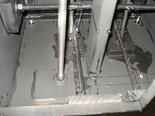

In the last set of pics, there were the #10 rods that I installed for mounting the driver.  To those, I glued a 7/16" rod.  I used gorilla glue, and tie wrapped them while the glue was drying.  It is the vertical rod in this picture.
The horizontal rod is a 1/2" threaded rod that goes from side to side.  All the rods that go to the side walls end into blocks that are around 4x4x1.  I used nuts to push out against these blocks.  The blocks were glues against the side walls, and I used some locking nuts, and thread lock, to keep the nuts from coming loose.
Another pic of the inside.
I painted the inside, because I read about MDF breathing, and it is better to seal it with paint.
I positioned the braces to try to make them intersect as much as possible.  Then, I used gorilla glue to hold them together.  Now, they are very stiff, you can push on them hard, and get almost no deflection.  The #10 rods used to deflect easily, maybe 3/4" from side to side, before I reinforced them.
One more, from the back.  I added three rods on each side wall, and there are 5 rods going from front to rear, that also hold the driver down.
I installed some spiked feet from PE, but I forgot to take pictures of them.  Only problem here was when I drilled the front holes, I hit the L bracked I added to the front wall, so I had to move the feet back a little, and had to fill the holes with sealer.
