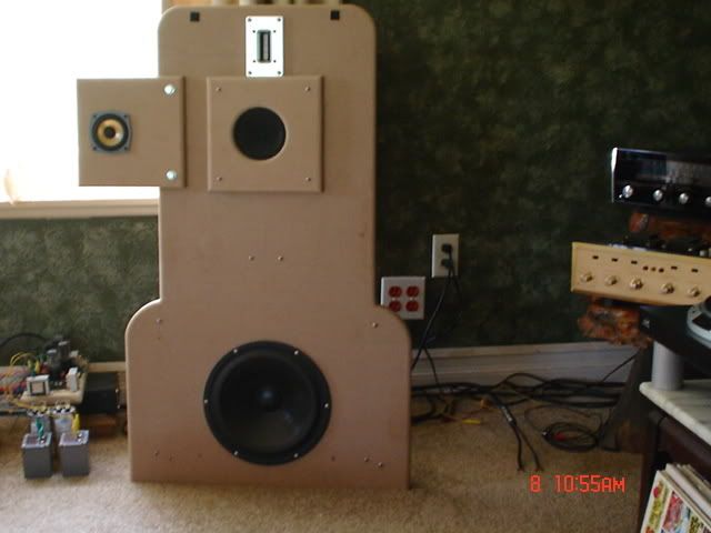

Here is a pic of Baffle experimenter style..If the Jordans don't work out on OB, I will just build your Jordan monitor with the G2 ribbons I allready have, I also have a need for a nice monitor. I don't mind the price, really not bad considering full & mostly awfull commercial offerings @ 1k. I have some 1k & up monitors that do not keep up with my OB's shown, even with the little $ 20.00 Calrads in the middle of baffle. Hi-passed line-level I can get some good spl out of em. I am sure the Jordans will bring what I want..The little yellow Kevlar drivers shown are some JVC 3" from there highend mini monitors, the solid cherry ones..Cool little driver & can also get these to perform quite well & way loud enough w/ 22w of tube power.Hi=passed of course, but only a single .01uf cap @ input of amp. No filters bieng used. I should be able to order the Jordans by weeks end. Thanks for the source for them...
