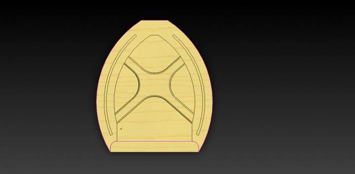

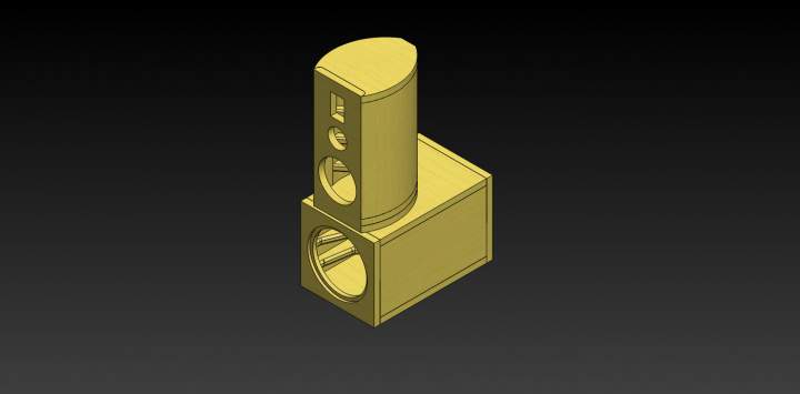

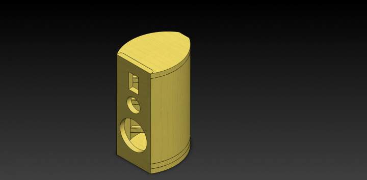

Got bored so I spend some time cooking up an idea, not something i'd be able to do real soon but perhaps in the near future.
Translam built Tempesta that utilizes damping/sound proofing materials to assemble the pieces and inside the walls.
Bottom compartment for the x-over and then ideally the monitors would be sitting on a pair of 12" subs (Rythmik 12" GR research?).
Not sure how high the Tempesta's need to sit above the floor (or relative to the LP).

Rick,  i wonder what would cause that... The shape alone (curved sides) would give it more rigidity than a typical box.
Navin,  that would be the idea.  I just modeled it up as one piece to make it easy.  The only thing I would check is the strength of those adhesives because some of the ones I have found say they are not a "structural adhesive".  If it is stronger than the wood than I would say its fine.
For this I would build the baffle out of two pieces and attach them with the damping material too.  The source of the vibrations would be coming from that first baffle panel, so the more I can dampen it out before it gets to the cabinet the better.

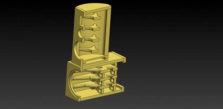

Man you've tried just about everything.  My thought was to try something that has been proven out by other guys like Ryan @ Vapor.
I wonder what we are really trying to accomplish with all of these different methods..  We use thick walls and stiffeners to increase the resonant frequency which reduces deflection and thus dampening.  Then we add damping materials which add weight (thus reducing the resonant frequency) and increase dampening.
Aren't there two things going on:
1.  The energy is causing the panels to resonant which causes noise
2.  The sound in the box is getting outside the box thus causing noise
I would think #2 is the bigger problem but it certainly depends on which part of the frequency spectrum we are talking about.  A tweeter isn't providing output in the region of the panel's resonance but a woofer certainly is.
That's why i think a combination of stiff panels to drive down deflections and sound proofing material in the walls will ultimately reduce the box's influence on the sound.  Also, damping material between panel (baffle and side panels) will help reduce energy transfer between panels.
Don't know enough to know if this would require adjustments in the cross-over or would just provide cleaner sound with the same x-over.

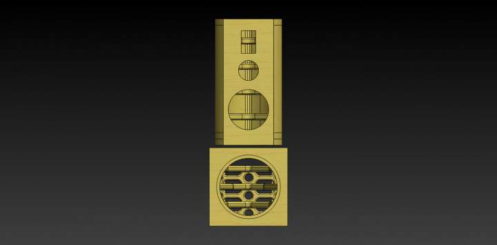

Added sub
Some shapes can create a strong resonant mode. Damping the stiff panels to reduce ringing is important as well.

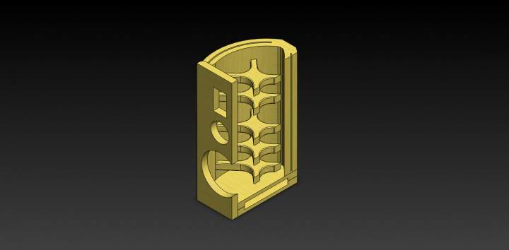

Don't think "my" shape is as exotic as those Norh speakers or even the 2-way we are talking about.  It would really be more of a fun thing for me, try and build a super dampened cabinet with some awesome components.  If it doesn't work, I scrap it and buy some pe cabinets.
Rick, do you think having braces behind the drivers is a problem?  Or would it be better/safer to have the braces in the spaces between the drivers?
Some of the Nohr problem was from the round baffle which is really bad for diffraction. The shape you have is similar to the cabinet I use so I don't find that to be a problem. As far as the braces that looks fine though it would be more common to have them between the drivers.
