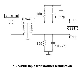

You're thinking is reasonably good.  The frequencies of the spdif digital signal are RF so you want to treat the signal chain like you'd treat any RF system.  You get best power transfer and minimal reflection when all impedances are matched.  The output impedance of the transport should be 75 ohms, the connectors should be 75 ohms, the cables should be 75 ohms, and the dac input impedance should be 75 ohms.
Regarding where's the best place to put a digital transformer, I've heard people suggest that the right place is in the transport but I'm not sure I can argue convincingly that one place is better than the other.  Since as a DIYer I can overkill everything, I tend to use transformers in both the transport and the dac.
On the dac side, I actually like 1:2 step up transformers and typically use the Scientific Conversion 944-05.  A 1:2 transformer converts impedance with a 1:4 ratio, so you need to terminate the transformer with 300 ohms.  I've found that a balanced termination works best as shown here:
---Gary

What are the 10-22 pF caps for?
Steve N.
GBB
Re: Which leads to more questions
« Reply #11 on: 21 May 2006, 11:34 am »
Quote from: audioengr
Steve N.
Steve,
These were first suggested in some interesting articles on usenet a long time ago by an engineer by the name of Pete Goudreau.  According to his measurements of the Scientific Conversion 944-05, they help damp a slight peaking of the response of the transformer.  More importantly,  they provide a path for common mode noise that couples across the transformer due to winding capacitance.
Give them a try - you might be pleasantly surprised.
---Gary

Contrary to what Scientific Conversion will tell you.............low capacitance transformers is not the way to go. They have too much leakage inductance. Only thing worse is the 2:1 versions, that have a 4:1 impedance ratio.
Actually, you can use Pete's technique on a 1:1 transformer, just remember to put 100 ohms on the primary side to make it 75 ohms. A zobel network helps out, as well.
