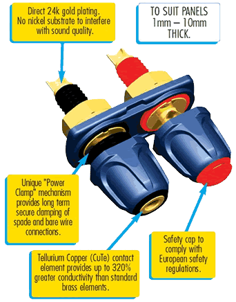

I'm planning on building a five channel UDC180AD based amp starting next week.
Decided to go with the eichmann cable pods.

I've never used the Eichman speaker post.   Let me know what you think of them.
