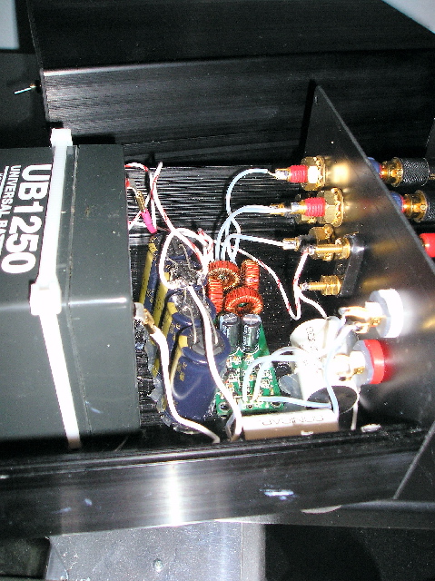

Here ia a rather poor picture of the prototype amp based on the 41 hz AMP 3 board.
The board did take me a bit longer to put together and get working. I JUST fired it up.
The amp uses very short runs for input and output. Less than 3" of wire for each connection. This amp, I built using the same Cryo-treated silver I use in the SUMMIT cables.
I used Sonicaps for input coupling in place of the stock electrolytic or SMT caps supplied with the kit. The torodial inductors were wound with cryo-treated, solid core, 99.9999% pure copper.
I added a capacitor bank between the SLA battery and the board. The bank is made up of 4) 4700 uF caps to maintain low ESR.
Input connectors are WBT NextGen. Ouptut connectors are Eichmann CablePods.
I do have a Tripath 2024 amp built with Sonicaps I can compare it to. It will take some time for the new amp to break-in.
First impressions are that the 41hz board, at least the way I built it, has a richer lower midrange and deeper, tighter bass than the eval board. Highs are smooth and extended.
I will post more as the amp break-in progresses.

Wayne:
       Neat! I think the cap bank is a good idea. I do the same with my modded SI. Big improvement in dynamics and speed.

That looks awesome Wayne!  How's it sound so far?

Wayne's amp 3 sounded very good indeed at Ed's over the weekend.  It immediately struck me as having more midrange and low frequency weight and seemed smoother in the high frequencies that my modded 2024 evaluation board..  Also, being a tripath, it exhibited great speed and resolution.
I didn't get to spend much time with the amp, so that's why my remarks are pretty brief and general.  However, my first impression was very positive.  :)

Yep, It's good! So good that I did not bother to hook up my 2024 board for comparison. MUCH better than my amp..........I knew right away.  Good job Wayne!
