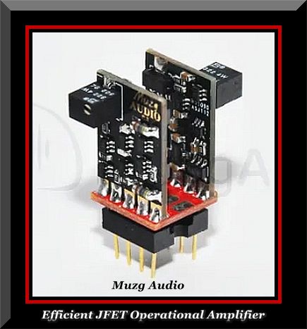

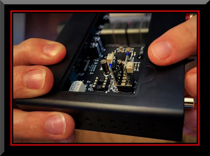

Here is another Polish manufacturer of audiophile Op-amps. I've heard some positive comments regarding these Op-amps. Anyone on AC used them?
https://muzgaudio.com/en/produkt/efficient-jfet-operational-amplifier/
This YT reviewer, shows it actually installed in a Douk A5 amp, in link below. If you look closely at his A5, you'll see he has a Ver: V1 amp.
https://www.google.com/search?q=Review+-+Muzg+audio+Jfet+opamp&rlz=1C1UEAD_enUS1146US1146&oq=Review+-+Muzg+audio+Jfet+opamp&gs_lcrp=EgZjaHJvbWUyBggAEEUYOTIJCAEQIRgKGKABMgkIAhAhGAoYoAEyCQgDECEYChigATIJCAQQIRgKGKABMgcIBRAhGKsCMgcIBhAhGKsCMgcIBxAhGI8CMgcICBAhGI8C0gEKMjU4NDdqMGoxNagCCLACAfEFN8lHjMMGfrs&sourceid=chrome&ie=UTF-8#fpstate=ive&vld=cid:5afd7fd4,vid:LvNzwuyro28,st:442
Audiophile's never have enough Op-Amp options, for either amps, dac's and preamplifiers.
