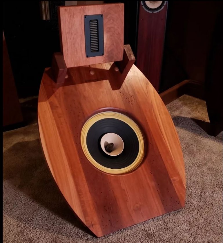

Being a Carver Amazing owner I always liked OB and LA.
Check this OB DIY project from a member with 8 Visaton B200:
Yo FRM, have seen this before. Maybe it was you, or maybe someone did a very similar version. Never heard those, how are they? Don't you lack crisp highs as needed in all kinds of percussion, cymbals, mic hiss from breathy singers etc.? I'm very sensitive to that, or rather, i really miss that if it is not present in the sound signature. Most full ranges don't touch a tweeter for me..  Or does the number of drivers make this so effortless that you can tune 'em to a Fletcher Munson curve?
Would want 'em a couple feet from side and back wall too, but that may not work in everyone's house.. :-(

I cant remember what AC member built this nice speaker.
