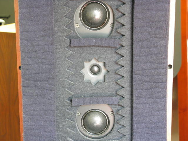

You could add a 5mm black felt to the front baffle as the vintage Duntech 2001.
