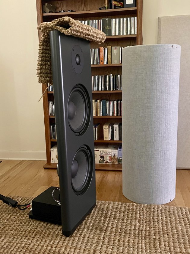

I'm using an integrated PrimaLuna EVO 200 with Spatial M3 Turbo speakers. I have a mix of crackle and buzz from the right channel. The TT, amp, CD player, and streamer are all connected to the same power outlet source. The crackle and hum is from the right speaker only and it is intermittent without any pattern that I can notice. So the crackle and buzz is not all the time, but is there most of the time.
What I've done without any luck:
I changed the speaker cables.
I swapped the speakers from left to right - crackle and buzz is still from the right channel. So, it may not be a speaker issue, I think.
However, when I connected a different set of speakers to the same integrated amp there is not buzz/crackle.
I'd appreciate any advice or tips or things to try out.
Thanks
