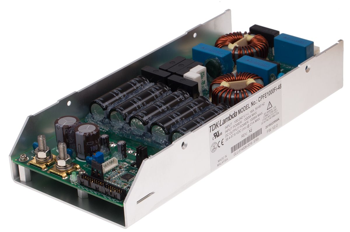

IMO, it should not cost 3k euro to replace the caps. I would try to get another quote for the repair, from an audio equipment specialist if possible.
100% agreement, that is an outrageous charge for a recap. Unless the switching PSU is custom with non-standard voltages would explore finding new ones. If not, a recap should not be that tough. Below is a pic of an open-frame, multi-voltage, switching PSU. There's not that much going on -
