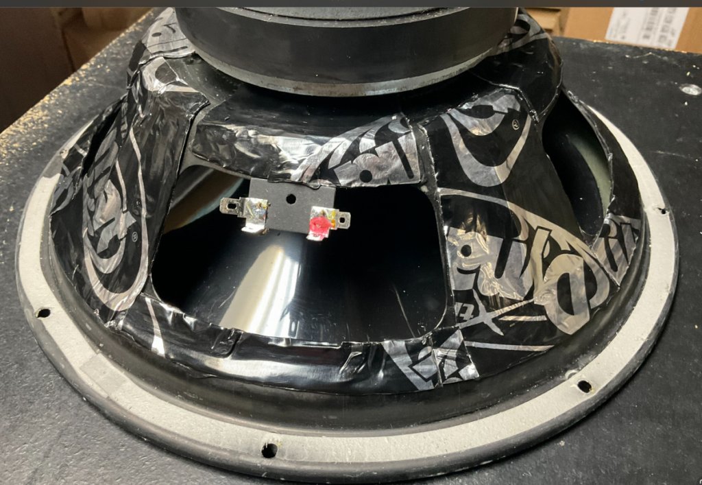

Re: Original VMPS Larger Sub upgrade options
« Reply #6 on: 5 Oct 2024, 04:49 pm »
I think Brent nailed it, likely no issues with them as they are. I too have a pair of larger subs and they have never given me any issues after many years of use. Using a 12" and 15" active drivers with that much displacement they do not have to make large excursions which is likely the reason for longevity. I did find a spare 12" and 15" original VMPS drivers which I found used on eBay. They do not come up often, but they are out there. I was glad I found them just for insurance. https://www.ebay.com/itm/226138181072 https://www.ebay.com/itm/226138181077. If you have any issues with the active drivers reach out (cost + shipping). Congrats excellent subs IMO.
