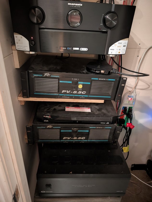

Hello just postin my theater I did in 2010.
Will be adding atmos speakers soon.
Currently I am trying to figure out this Marantz av7706. Not happy with it. With my old emotiva Movies were exciting to watch. Now Godzilla sounds like a mouse and his footsteps are weightless. Gunshot are like bb guns.
equipment: Onix Rocket 760 fronts RSC 200 center, rs250 rears with axiom qs8 sides all this combined with infinite baffle 18" fi subs,
Power:
Either Crestron1260 6 channels bridged for fronts and center rears and sides and future atmos on the rest of the channels. Or
rotel 985 and 980 power the setup. Also there is 6 kickers powered by whatever I have.
Pre-amp is AV7706 "wasted money"
