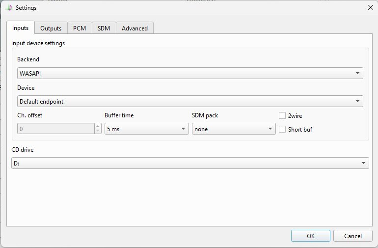

Reading the HQPlayer Manual pdf (located in the folder where HQPlayer installs) is necessary. Setup can be confusing at first. HQPlayer does a lot more than just play back music.

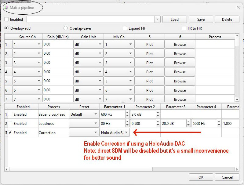

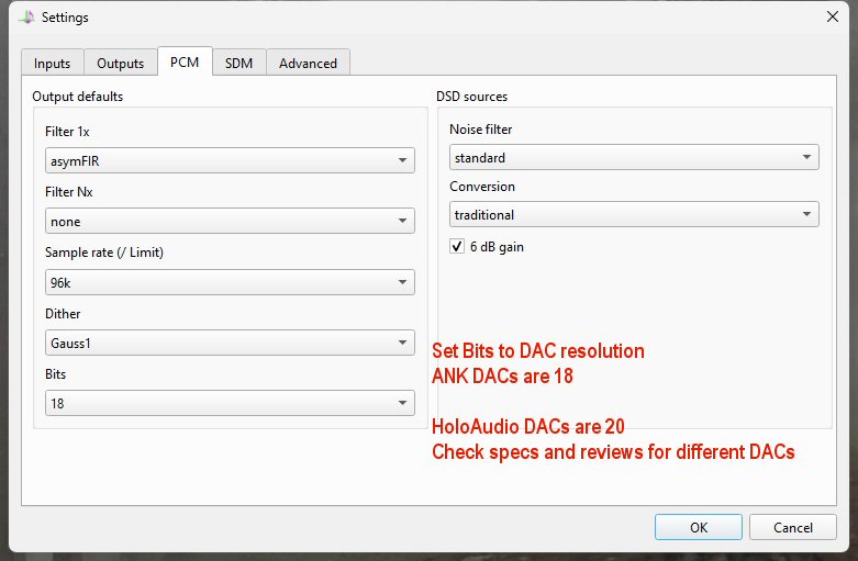

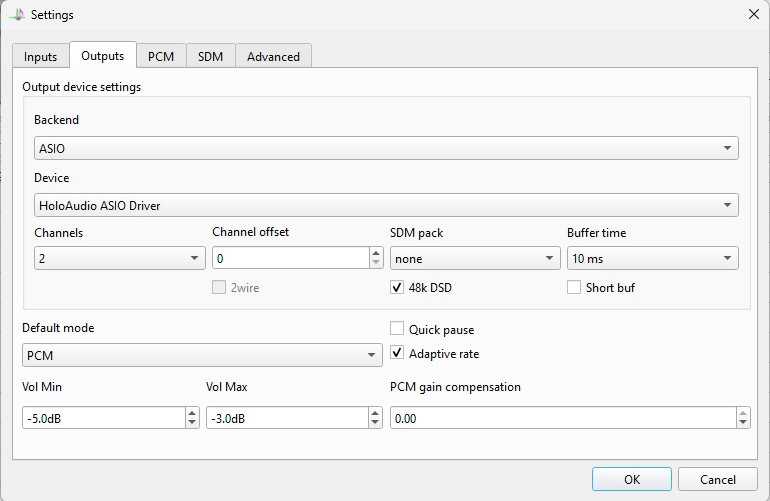

Here are my Settings, yours will be similar but different

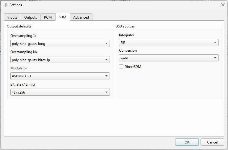

SDM (DSD) these settings are not used when using PCM and can be ignored

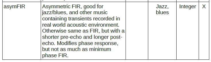

Filter selection is a personal choice, pick what sounds best, that is how everyone chooses a DAC. PS Audio uses a FPGA (Field Programmable Gate Array) chip, new filter algorithms (updates) can be installed changing the sound of their DAC.

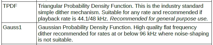

Our audio club will be comparing the sound of my HoloAudio May KTE DAC to a ANK 5.1 Signature - Level 5 DAC so I picked a filter and dither setting that should make it a level playing field. I picked asymFIR because I like the way it sounds and it is a digital filter. ANK DACs use a digital filter, their website states their DACs don't use any analog filters. Gauss 1 dither is chosen because ANK DACs can play 96 kHz. TPDF is also recommended but it is limited to 44.1 kHz recordings.
