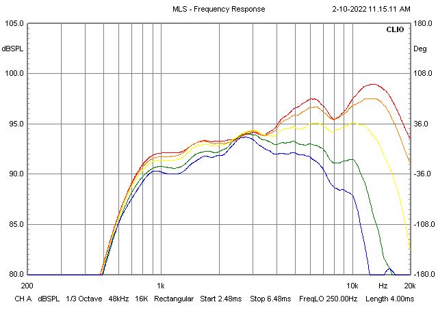

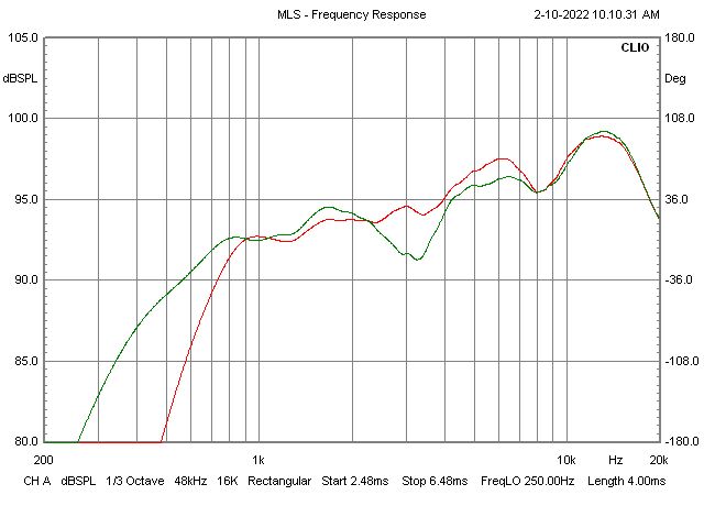

To get an idea of it's overall performance you can also check out the NX-Bravo measurements.
Here are some raw responses when in a 8" wide baffle:
On Axis (Red is with the cup installed)
Horizontal axis up to 40 degrees

The bunching up at 2700Hz is due to the 8" wide baffle.
The 7.5" of the final cabinet pushed the bunching up around 3000Hz the size of the round over you use also has an effect, the larger the round over the less pronounced it is.
The 8" baffle I tests either had 3/8" or 1/2" and the first pair we built out used 3/4" 2nd pair was 1/2" so it stands out a little more.
The only means to avoid it would be to have a baffle that continuously curves away from the driver.

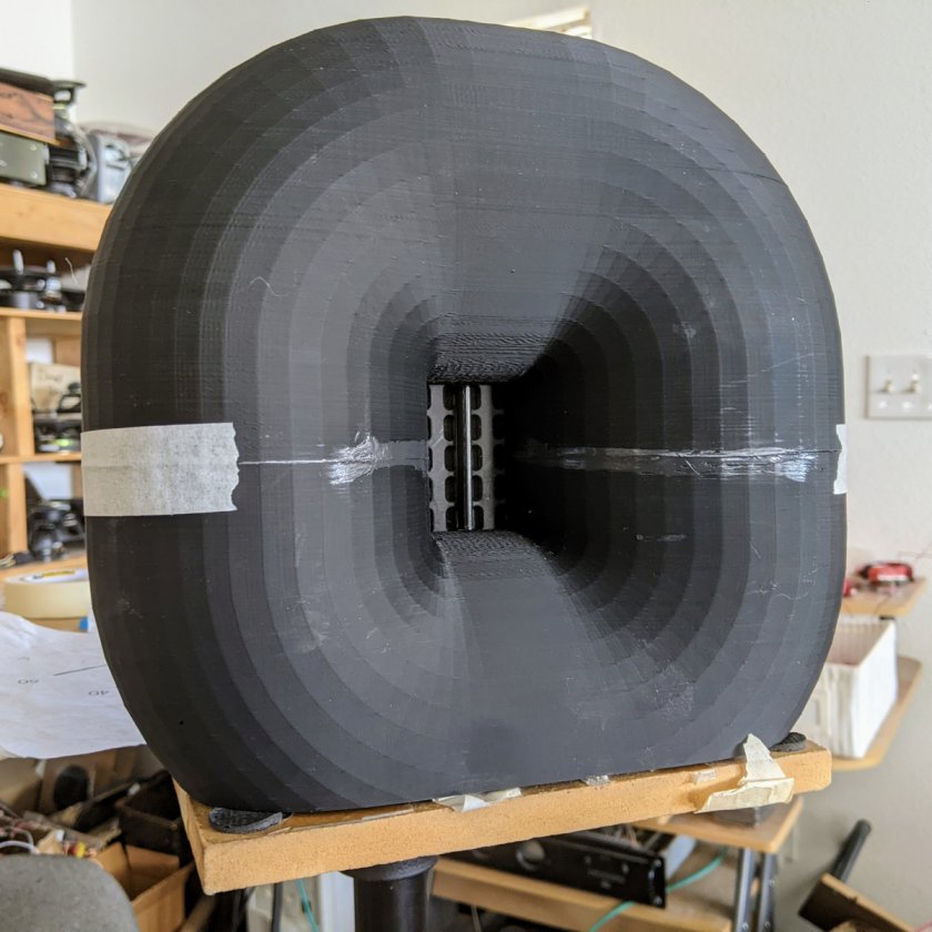

As for pairing this driver to a 12", it would work better than most drivers tend to be limited to 1500-2000Hz. They begin to beam starting around 600-700Hz, so for a smooth horizontal response you will need a much larger horn/waveguide, much like this:
Which when made from MDF, would measure like this:
This would allow you to cross to a 12" woofer at the frequency ranges where it begins to beam, while still using a small enough cap in a 2nd order network that will easily protect the tweeter even at such low frequencies.
