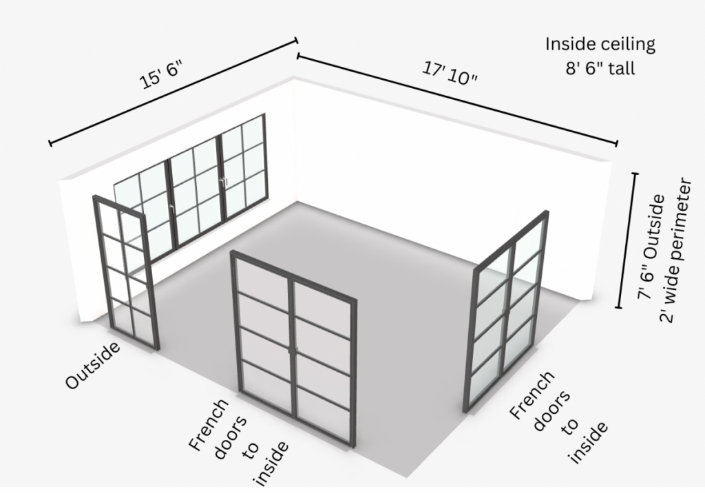

Alright, first, here's an image of the layout of the room with some dimension information.
I'm guessing most would classify it as a small to medium sized room.  First let me start with what this room is going to be / what I want it to be.

My understanding is the ideal layout for two channel listening is to have the speakers pointed into the room where the sound is traveling in parallel with the longest walls...that may be a problem because of what is at either end of the longest walls.
The wall that has the windows (on the left wall in the photo) are a view out onto a pool area and it's really a pretty view.  So, I don't think I can put a TV / projector screen on that side unless I do something that is able to disappear when not in use.  I'm not against this at all, I just don't know how feasible it is.  I have been looking at some UST laser projectors with "pop up" ALR screens - that may be an option.  I would also like the screen to be in the 100" ballpark give or take a few inches if necessary.
The wall on the right with the single door in the photo is actually french doors leading into another room that I can't really get rid of.  So putting anything on that side of the room is kinda out.
Then there's the option of going the other direction and setting the room up wide for listening which would likely work out best due to the layout with doors and windows, but from what I understand it makes the listening position / speaker position a bit more of a challenge.  With this setup it'd be really easy to put a TV / Projector screen on the back wall (only wall that is a clean slate), put sound absorption curtains on the windows and doors on the left and right sides of the room, as well as any additional treatments necessary.  Again, I think this is the "easiest" setup, just don't know how well it'd work with the listening positions, speaker positions and the 3-dimensionality I seek, which is the whole reaosn I'm looking at the NX series of GR Research speakers....
Any thoughts?  Would love to get some outside ideas, and suggestions on whether the NX-Treme's are overkill in a room that sized and I should just get it in my head that the Oticas will deliver the goods and I can rest easy...
Looking forward to the feedback on this :-)

If all those doors are glass, good luck!
I had much less glass -- room is 16 x 30, with tall sloping ceilings, and solid glass on one 16 ft wall -- and the echo / reverb was a nightmare.  System was unlistenable.

It's perfectly fine to use long wall placement.  I've done both as well as corner placement.  You haven't mentioned speaker placement, but best placement for audio, which is well out into the room, is usually the opposite of home theater placement which is usually next to the screen.  Assuming a modest compromise between those two placements you're still giving up soundstage depth to some degree, which is one of the best features of short wall placement.  So go ahead with the long wall placement that makes the most sense in your room.
Yeah, every door has glass panels on them.  I can potentially change those to solid doors which I’m not opposed to.  The windows are the only ones I really can’t / don’t want to touch.  I figure I’ll do my best with treatments and coverings and go from there.  If the room still isn’t behaving, I’ll move onto replacing doors :-)
Excellent - thank you for the feedback.  Yes, my plan is to bring them out into the room at least 3’, maybe 4.  I think the biggest problem with using the long wall for the setup is that means there’s only another 11-12’ from the back wall at that point and from what I understand you want the listening position off that wall so it really squeezes the space.  I’m ok with compromising but I don’t want to steal what makes the NX’s so special.  I’m sure I’ll have to tinker a bit, but hearing others say it’s ok to use the wide wall is encouraging.

I suggest lots of thick curtains over the glass, even for those French doors.
That room is not very big for huge speakers and a lot of glass. Pulling speakers 3-4 foot out in the room and seating position 3-4 foot from back wall is going to put you about 8-10 foot from the speakers in more of a nearfield listening position. The benefit of that room is you could use wider speaker spacing to get deeper soundstage. I never heard Danny's NX line but perhaps the Oticas would be more suitable? Not sure and maybe others more in the know will chime in.
I wouldn't change from glass to wood.   It is still a reflective surface, and needs to be treated the same way.   IMO, your plan to use thick coverings and treatment panels is the correct one.
Yeah, that really was the challenge - going with the wide layout, it reduces the amount of room between the listening position and the speakers but I may have to make that sacrifice.  And I'm with you - I plan to have as many acoustic absorbers as possible...

Hi John - thank you for sharing all that!  I just went down all the rabbit holes in each of the posts.  Your room actually turned out looking rather nice - I was a little shocked when I saw that you mentioned you used moving blankets to tame the room, but with the additional coverings everything really does look nice.  Thank you again for sharing all the information - I really did look through it all!
I think the biggest challenge I'll face is the windows on the left side of the room.  If I can figure out what to do over there that will "work" I think I'll be good.  I believe I'll have the ability to put bass traps in all the corners of the room so I'm thinking those windows will just need to be mid/high frequency tamers.
