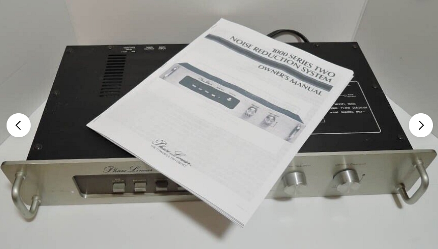

Is this what you are looking for? A seller on eBay has a manual for a 1000 Series 2. See if he will make you a copy or pdf for a few bucks.
https://www.ebay.com/itm/166532290998?hash=item26c61919b6:g:1sgAAOSwKiBllN5n
