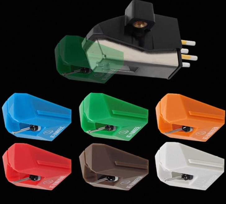

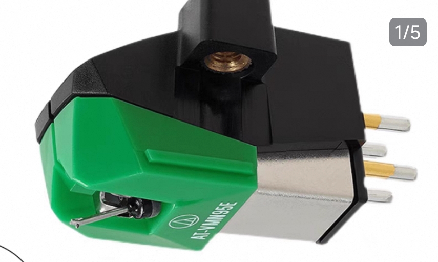

There is plenty of Audio Technica cartridges for a small amount of money and with spectacular results. The VM95 exists in different shapes and these cartridges are worth every penny.
https://www.lowbeats.de/test-audio-technica-vm95-6-mm-abtaster-bis-200-euro/
And the Cartridge is compatible with different stylist, you can finish with VM95SH (Shibata) if you like.
Where I live the ATN VM95E is less than 40€.
Hey!
  I have the "C" conical version, the blue one... the price has gone up to $49 now here in the US... on my second turntable... 1971-72 Transcriptor Hydraulic Ref/SME 3009II Improved and it is a fun and very enjoyable cart! No, it won't replace the cart $475 Hana EL on my main turntable the Helius Alexia/Omega arm.
   I have no problem listening to the now $49 AT conical cart, never feel to rush back to my main turntable once the music start. My go to recommendation for inexpensive cart if anyone asked me.
