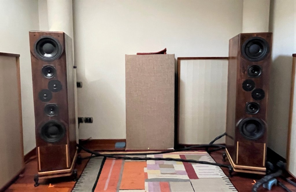

Just found a photo you posted from your Ulysses thread
The rectangular room just isn’t wide enough to do the Ulysses justice
A much bigger factor than how far you can bring the speakers out into the room or how much distance between you and the back wall.
The other room is more than adequate to do that.
https://www.audiocircle.com/image.php?id=250638
They will sound much better in a wider room
The 5.7 x 5 meter will work very well.
I agree that the rectangular room is too narrow, in length it allows for variable placements of both the system and the listening point, while in width it lacks about 1 meter to make it a good environment for ulysses and bow
A picture truly does tell a thousands words!  :o
I retract my suggestion to place the speakers in the second <long and narrow> room for two reasons. The first is I now realize your speakers are larger than mine - I should have remembered this, but didn't:oops:  The second is because my smaller Apollo speakers are in the widest half of my living room/dining room space. The widest half is 15 ft wide while the narrow half is 13ft wide. The very heavy dining room table is located in the narrower section, and I never tried to move the table out and place my speakers there.
