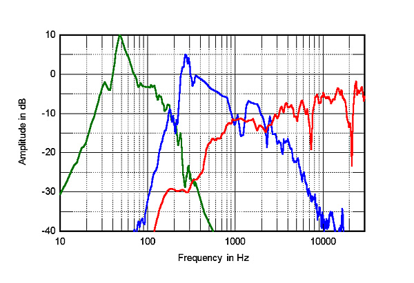

The ribbon has a shallow slope which means it extends quite low.  If you use a steeper slope, you can take some of the stress off the ribbon by preventing it from extending so low into the midbass region.  It will sound more "relaxed" as well.  You will also have to redesign the rest of the XO network accordingly.
FWIW, I redesigned mine so no 3 drivers are playing on top of each other.
Magnepan 3.6 Ribbon (from Stereophile):
Magnepan 20 Ribbon (from Stereophile):
