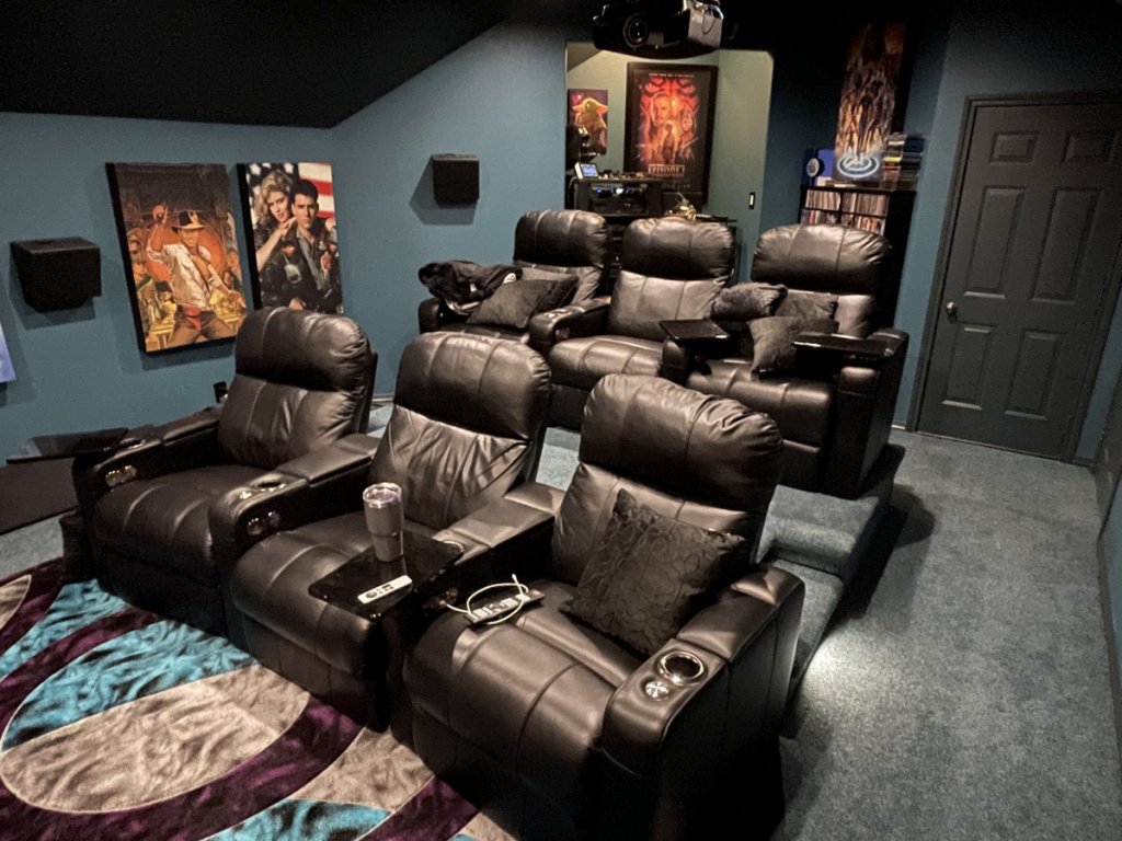

« Reply #5 on: 2 Oct 2023, 12:56 pm »
I don't have NX (yet), but I have X-Statics, and in my HT setup I have both.  The OB subs (Double Trouble) are connected to the high-level coming from an Odyssey Kismet stereo amplifier and connected from there to the X-Statics.   Music sounds incredible as does movie soundtracks.   Then I have a pair of SVS SB2000 Pro sealed subs, one at the front of the room and one in reverse polarity at the back to add depth to the center and all of the surrounds / ceiling ATMOS speakers.  To top it all off, the theater seats have Soundshakers in them.  My goal was to recreate the Dolby Cinema experience, and everyone I've demoed the setup to is blown away.
