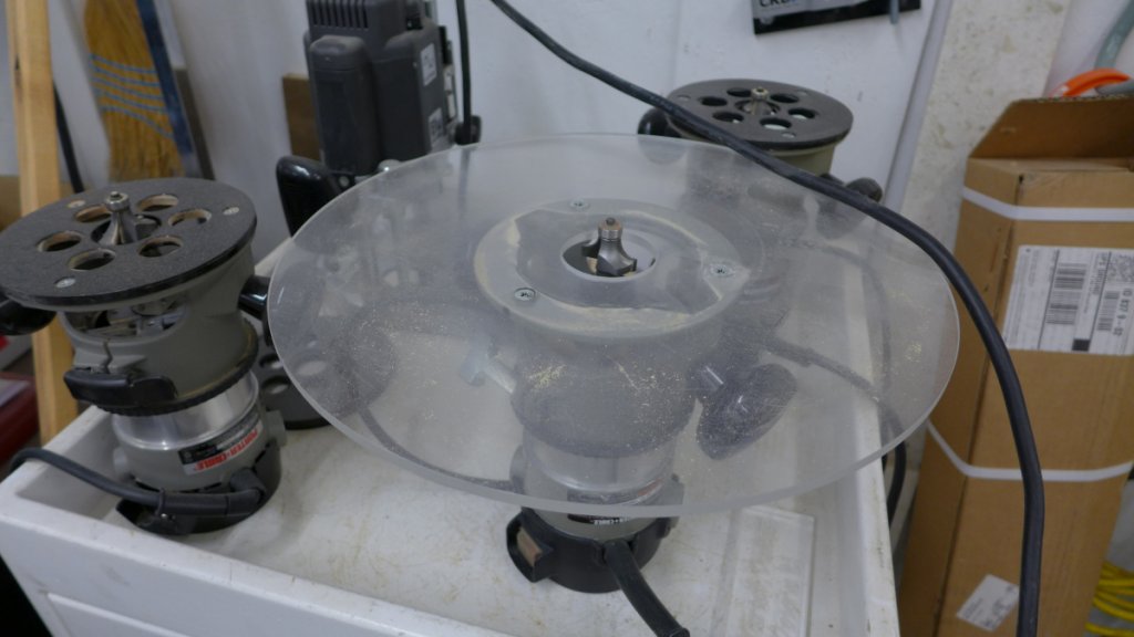

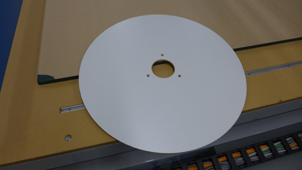

As Danny points out, clearance from driver cutout to cabinet side may dictate radius because of cutter diameter. If you want to make it kinda error proof, attach a base to your router that won't allow it to tip into driver opening. Doesn't even have to be round or pretty. And assuming you have box gutted, shop vac hose can be dropped into tweeter opening to keep the mess down.
Thanks Peter and Danny.  There are a few spots for each where there will be interference.  I may have to bust out a grinding bit. :). I have seen others suggest making a base for the router to keep it on some sort of surface the entire time.  Thank you for sharing those pics / advice.  I appreciate it.

After installing a large enough base plate so the router is always supported no matter where in the cut it is, I'd put the bit with the radius you want in the router then, with the router unplugged, move the router around the cut path and see if the bit hits the side anywhere. If it does, move down to a smaller size and repeat until the bit goes all the way around without contacting the sides. Cut a rounder using this bit. Then move up to a larger size bit. Start this cut in a section where it does not encounter the side of the cabinet. As you approach the point where the bit will encounter the cabinet side, be very careful. If the bit strikes the side of the cabinet, it could buck and try to pull the router out of your hands. If it gets sketchy or reaches a point where you do not feel comfortable continuing, stop. Use the larger bit, up to the size radius you want on the sections of the opening where it cuts safely. Then use a rasp, file, and or sandpaper to smooth out and blend the parts of the openings the router bit couldn't reach. This is slower and more hand work but safer.
