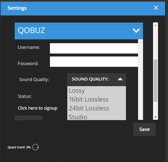

Did a search and couldn't find the answer to this.
I just added Qobuz streaming to my BDP Pi.
Tracks on Qobuz are 24/192.
MM and my DAC both say the songs are being played at 16/44.
In MM settings I can set the streaming quality level for Qobuz but the only option available is 16BIT LOSSLESS.
Is Pi/Qobuz capable of streaming full 24/192? And if it is, how do I enable it? I feel like I'm just missing a setting somewhere...?

@unincognito, that's odd. I have the exact same drop down but the only option is 16Bit Lossless.
Which BDP and MM versions are you using?

Update. I now have the full drop down menu with all of those options. 24Bit Lossless works great. 24/96.  When I select Studio (24/192) the channel light on my BDA goes red... no sound. Meanwhile the Pi seems to be playing the song, its just not getting to the BDA, or its getting to the BDA and BDA can't handle it.

SOLVED.
Circling back on this to post solution.
Turns out optical cable interface only supports up to 24/96. Coax supports 24/192. Switched cables and good to go.
