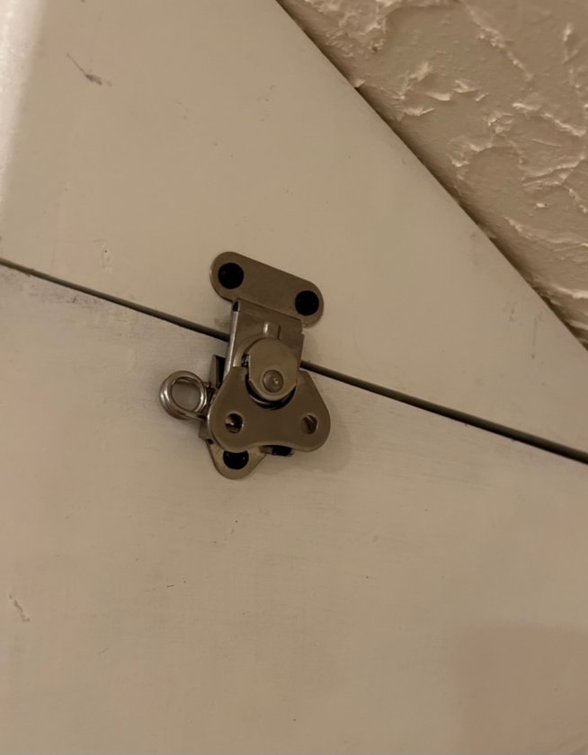

I used a simple mount system : 45 degree cut.
Which works great on vertical wall & okay on 30 degree ceiling… but the speaker itself was mounting horizontal.
So not stable, ie speakers wanted to fall off.
So got a simple lock mechanism…
