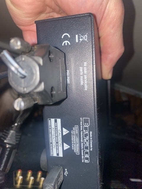

Sorry to hear your having difficulties with your BOT-1, would it be possible to post a picture of the BOT's rear?  I'm curious if its one with a first generation or second generation board, knowing might help us come to a conclusion.
Chris

Thanks for responding Chris.  We had a few email exchanges regarding my BOT.   You logged in remotely and everything looked ok in MM But we didnt get a resolution.  I suspected the power supply but I dont think that is it.  I think its the unit.   Somthing internal.

That unit appears to be running a first generation mainboard and the distinction being when we introduced the barrel jack connector we also changed the circuit design to use a low noise switching regulator from the linear design used in the BDP-1 power supply design, meaning the inefficient linear regulator used could be overheating and shutdown (ie no signs of power until the unit has had a chance to cool down).  If you're up for it I'd like to offer to have the unit brought back to Peterborough, for modification and testing.  I'll need the BOT itself and the power supply, you can either message me privately on audiocircle or contact our support staff, I'll let Mike and Adam know in advance.
Chris
