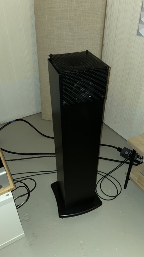

You could get a pair of rythmic fm8 subwoofers to act as stands.
Here a few examples plus my setup with nx-studios but with subs a foot away.

« Reply #12 on: 3 Apr 2023, 08:07 pm »
Hello,
I built these a few years ago and the decorating committee is still ok with the look.  I am glad too, as I never want to lift and move these again.
Gr-research 12" sealed servo-woofer with an external amp to sit below my N3Ss.

« Reply #13 on: 3 Apr 2023, 09:18 pm »
Hello,
Best,
That looks so damn cool.

Tyson and JDStrong,
Thanks for the high praise.
The side firing woofers don't seem to degrade the sound much if at all. Also, I get no ringing from the granite.
I found a car paint side jobber for the N3Ss but he disappeared when I had the woofers ready so I painted those (you can tell diy paint from 5 feet).
I had the granite cut from my kitchen countertop remnants.
I may be upgrading to NX Studios in the future.
Thanks again,
