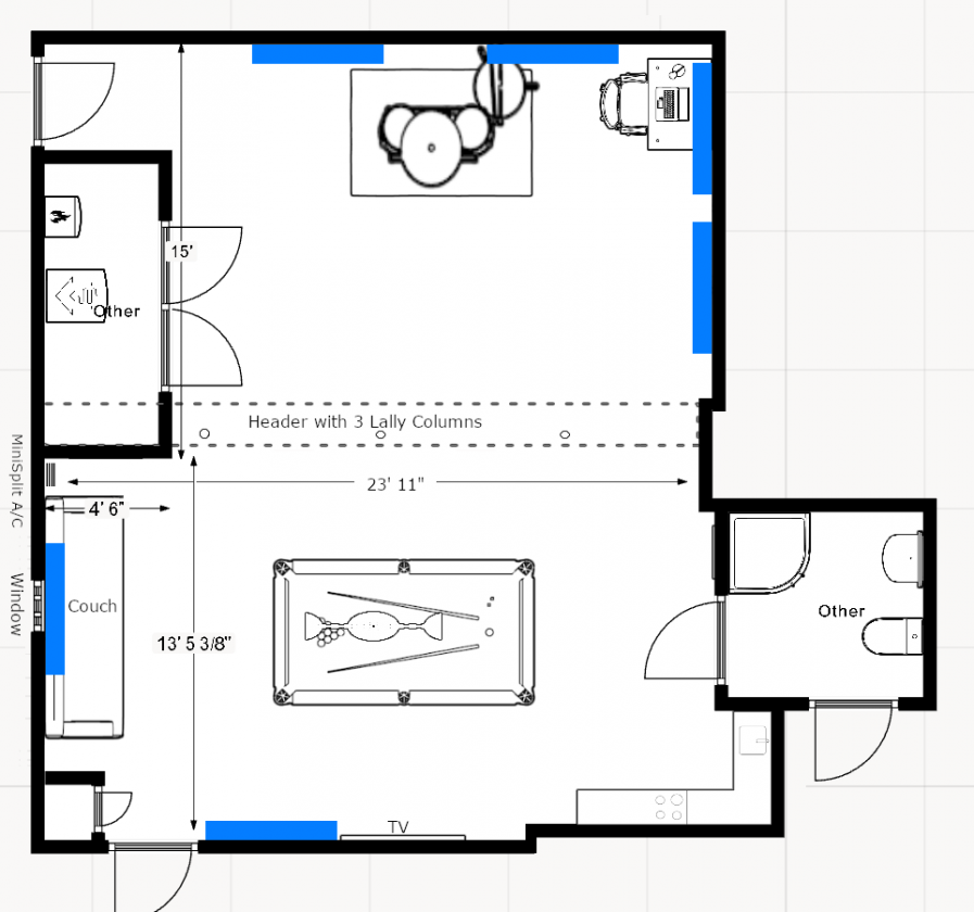

In that budget range you'll want to stick with broadband absorption for sure. I do suggest 4" thick absorbers at minimum for serious audio rooms (like our 244s); these are thick enough to help some with bass. 2" absorbers (like in our 242s) aren't much different above 300Hz but won't help the low end at all.
Performance in acoustics is mostly about coverage area, ie, the total surface area of all the panels you have relative to room size. For a 25x28 room you won't be anywhere near diminishing returns until there are probably 2-3 dozen panels in the room (probably well beyond your budget).
If you do put more than a dozen or two panels in the room eventually then you'll probably want to think about hybrid devices with diffusion built in too, to make sure everything stays balanced. Band rooms with just a lot of high frequency absorption with no diffusion or bass trapping can sound a bit strange.
If you are interested in using GIK products then you should do our free Advice Form on the website, so we can take a look at more detail about your room and give more specific suggestions.

On Friday, I had 3 friends over and we were blasting some music and chatting over it.  The acoustics were awful, and I understood the need to treat bass more after hearing that low end garble.
So, I put together a cad of the space.  See attached.  Where you see the blue boxes is where I'm proposing to put the 6 x 244's (48"x 12").  They would be at near ceiling height.
Main questions are:
1) Would this have a significant impact?
2) Would it be significantly better than the 4 mineral wools batts (Rockwood Safe N Sound 48"x15") that I used as a test?
3) Should the 244's include the diffuser option?
If these won't have enough impact, what is the minimum or what other products should I look at?
I get that I could add 20 of these without the diminishing returns, but unfortunately due to space, configuration, and budget, I have to be more limited and only look to achieve a decent state that's significantly better than what I currently have, rather than an excellent state.
