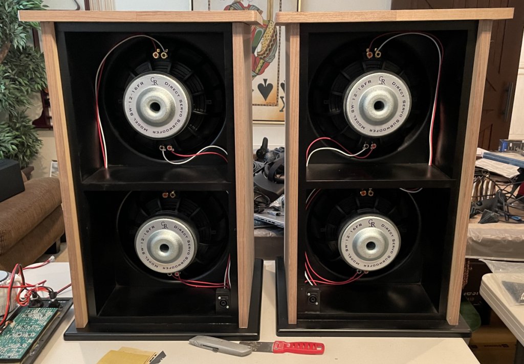

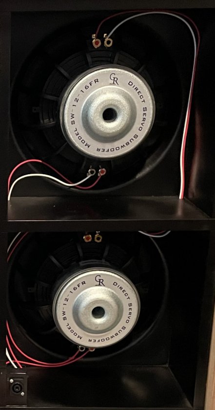

Hey gang. I looked at some of the build series, and maybe I missed it, but wondering if anyone has detail photos of how they physically routed the wiring on a dual H-frame sub. Not talking about the wiring schematic.....have that, what you did as far as routing, connecting to the drivers and then to the amp. I'm sure I could figure out something, but be easier to copy someone who has done before. Sorry if this info was previously posted and I missed.  Love to finish these subs now that I'm finally wrapping up all the repairs/remodeling on my buildings. Thanks.

If you're using the Neutrik connector:
Amp connection: (male connector)
Large red wire 1+
Large Black wire 1-
Small red wire 2+
Small black wire 2-
Woofer side connection: (female connector)
1+ = Driver coil + (input)
1- = Driver coil - (output)
2+ = Servo coil+ (input)
2- = Servo coil - (Output)
If you are wiring the amps directly to the drivers:
Large Red wire => Driver Coil+
Large Black wire => Driver Coil -
Small Red wire => Servo Coil+
Small Black wire => Servo Coil -
As for routing, most just drill a hole in between the divider between the two woofers one hole for the driver coils, and another for the Servo coils on the other side. The Neutrik connector gets mounted to a small board on the base of the tower.

Since the Multi-OB subs are, shall we say, unusual, I did things a little differently.
I wired the servo connections to an XLR jack mounted to the side of the cabinet.  Any XLR cable will work between sub and amp box.
The subs are wired directly back to the amp box which use two pairs of binding posts.
I had considered using a single speak-on connector but wanted the flexibility of different speaker cables.  Sometimes I consider doing the servo connection differently but it works for now.

« Reply #5 on: 9 Mar 2023, 01:58 am »
Does this help?

drphoto
Re: Photos of wiring install in dual H frame subs
« Reply #7 on: 15 Mar 2023, 01:01 pm »
Thanks to all, especially Vince as I wanted to see actual photo. I know this should all be self evident, but I find that other people sometimes will find a smarter way of doing a job and there's no need to reinvent the wheel.
