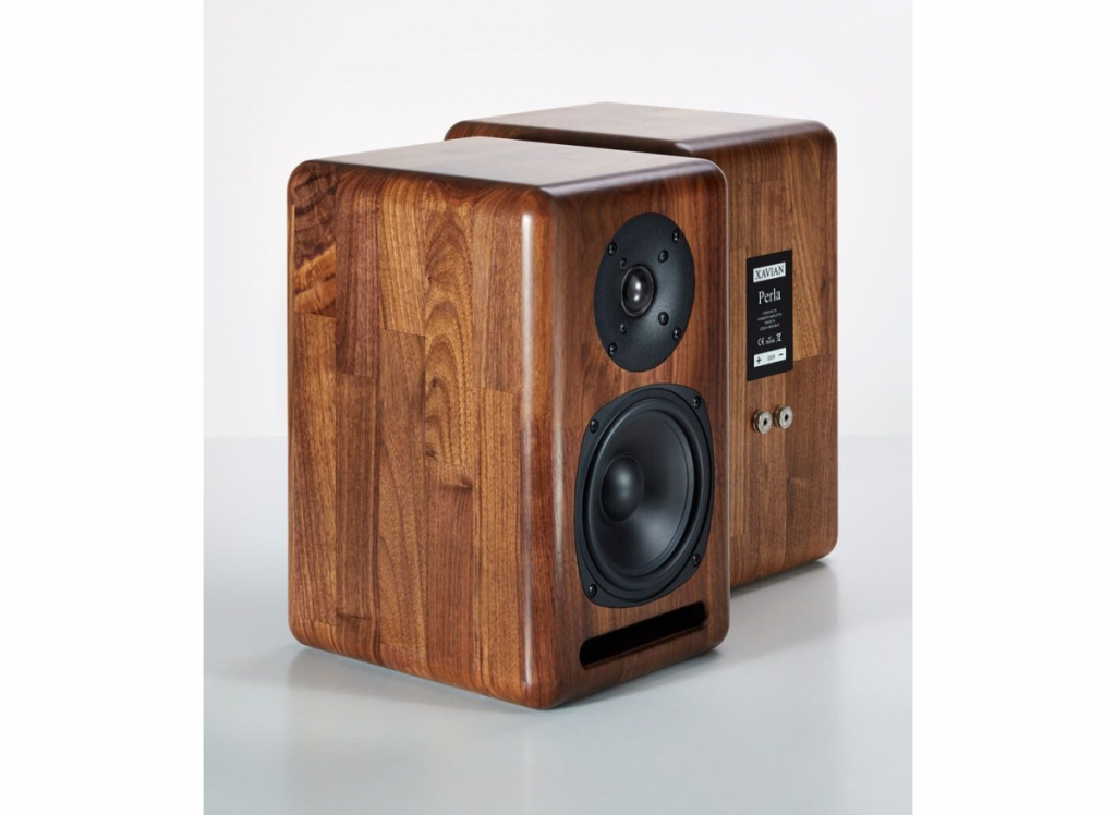

I am sure this has been asked in the past but has anyone built a pair of Encores with the port in the front?  Not necessarily a round port it could be a small rectangular cut on the bottom of the face.  It might take making the cabinet slightly taller but was wondering how that would affect the sound.  I'm assuming the cut might have to be a specific size for the tuning, that is why I am asking.  I have a desire to build another pair with a front port so they could be placed in an entertainment center.  I realize that is not ideal placement but in this room that is the only option.  I know I could go with other speakers that are sealed but really love the Encore sound.
Below picture is just an example of what I am referring to.   Something with a port like this.  Round is fine also.
Comments welcome.

A front port like that would cause some issues with the Encores.
The simple answer is to plug the port and give them a listen. They work well in a sealed box.
