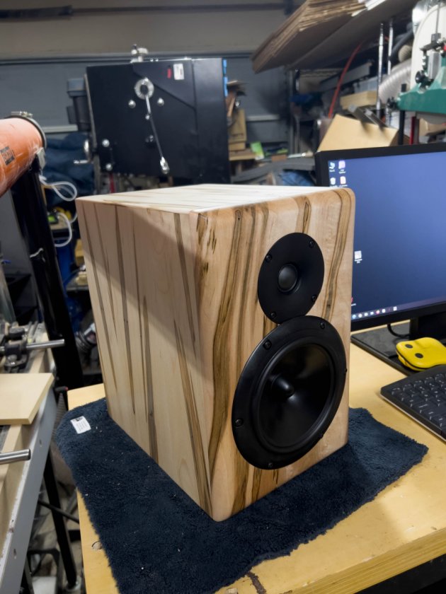

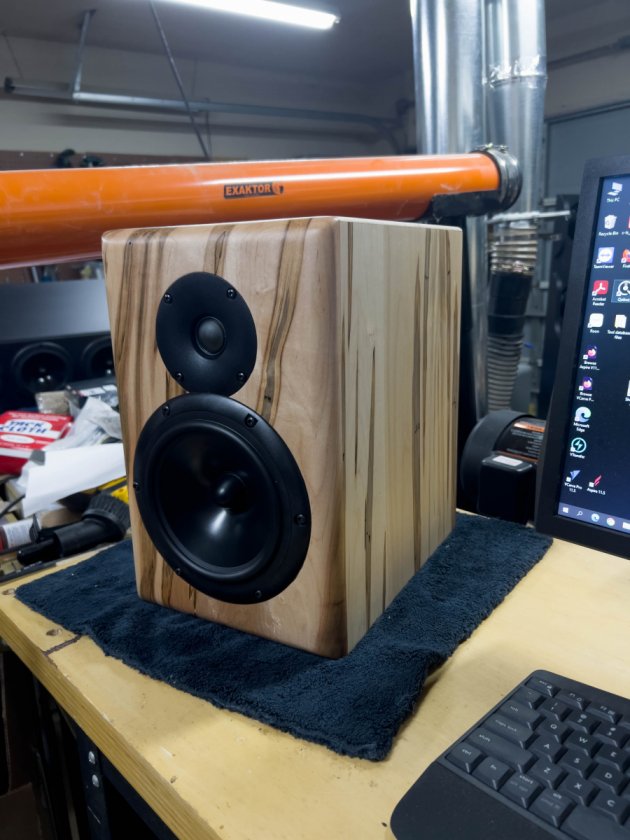

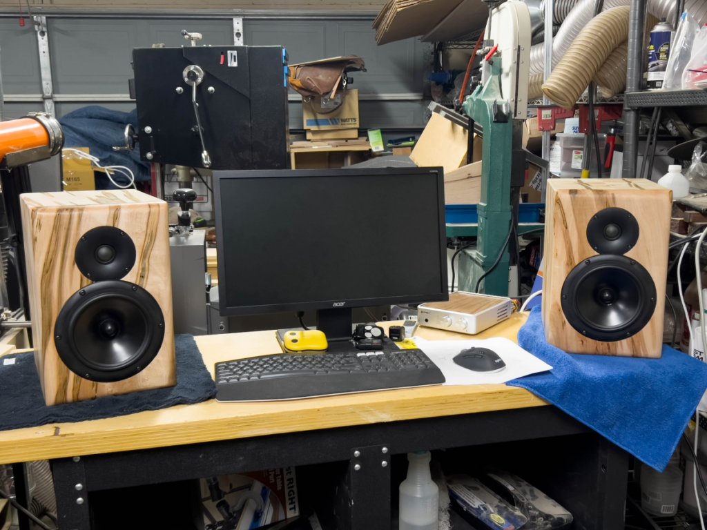

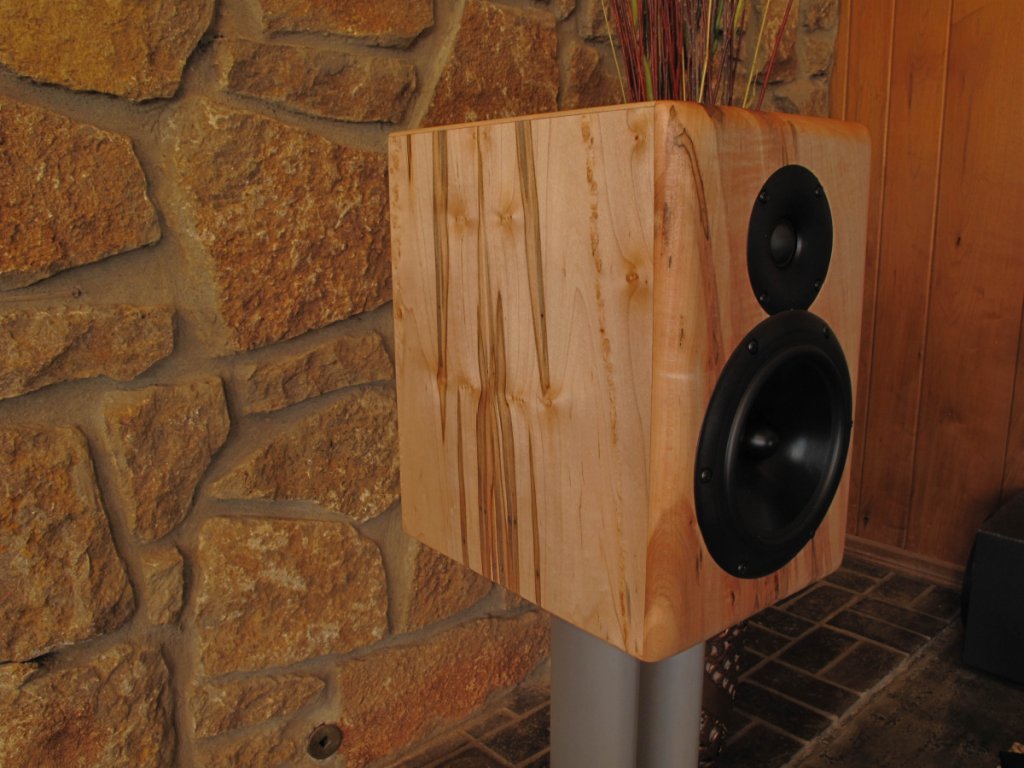

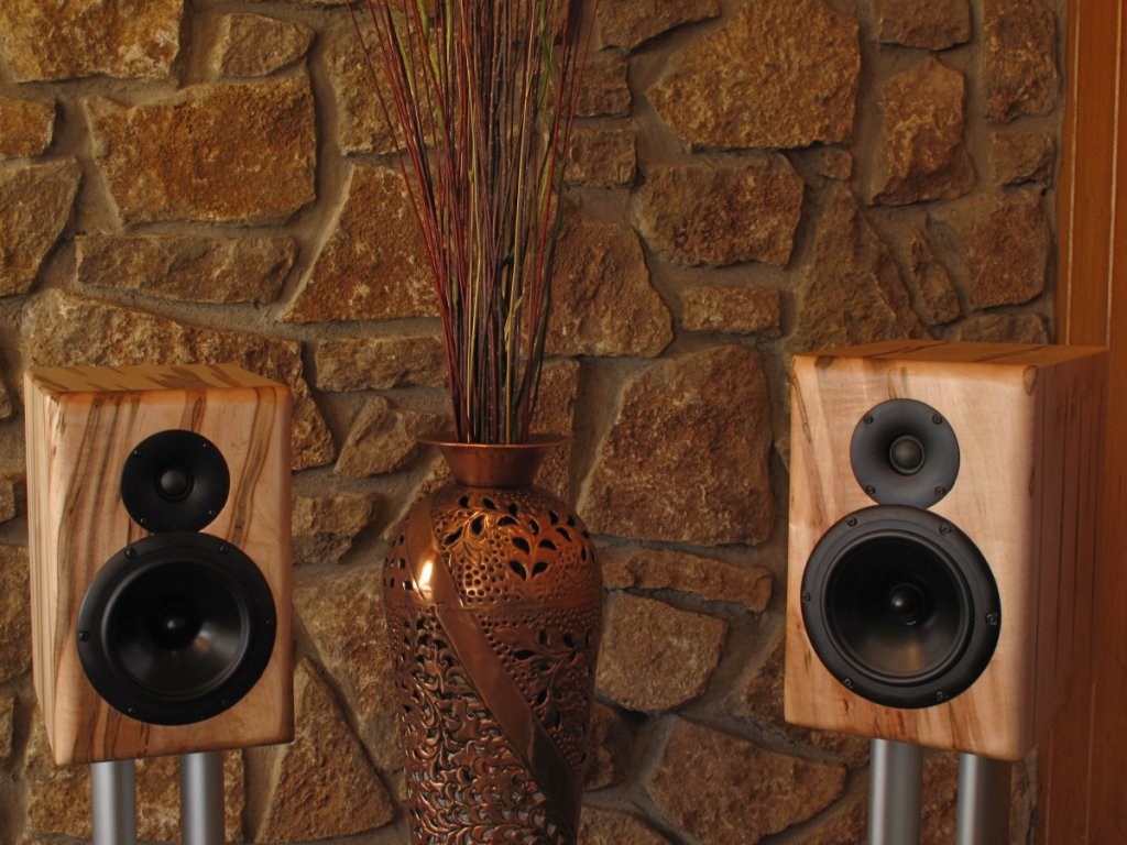

Starting to get caught up a little. This pair of X-LS Encores have taken awhile but are now heading to their home in time for Christmas. These are similar to the ones Ron reviewed. They are made with shop cut 3/16" panels of ambrosia maple laminated to the MDF sides, top, and back. The baffles are 3/4" solid ambrosia maple. The bottoms are black Dura-Tex over MDF. The finish is two coats of Rubio Monocoat 2C Pure followed by one coat of Rubio Maintenance oil.

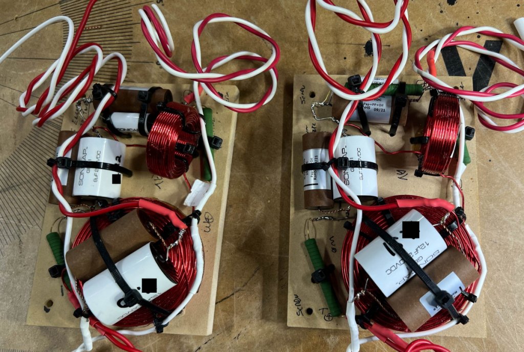

Here's the crossovers

See you have added a Mylex to the Sonicaps for the woofer.
Could you share your thoughts on the sound and possibly the value  :wink: because I have build my Encores now and are about to assemble it all. Should I add ??

Should I add ??
When in doubt, deck it out! Lol.
I have a miflex bypassing a Sonicap on my NX-Studios in the woofer circuit and while they are different drivers than the X-LS, the tone from that combo is a big  :thumb:.

Mike. Great craftsmanship and superb finish.
Definitely worth it, IMO.
I definitely think it’s worth it. Not necessarily from a bang for the buck standpoint but from a SQ standpoint. I think it makes the overall tonal balance smoother. There’s only two of them so it’s not expensive. I’d go for it.
These were a little more challenging than the last pair. For that pair the board I had was wide enough to get the top and side panels with one piece. With this pair, there were two boards. One was wide enough for the front and back panels be be one piece but the other was narrower so the panels were made up of two or three pieces. This meant gluing up wider panels after milling the pieces to 1/4” but that allowed me to play with the patterns. On some panels, book matching worked well while others required mixing and matching to get interesting patterns. With ambrosia maple, the patterns don’t always go all the way through the board which also made mixing and matching necessary.

Did you use the same value on the Miflex on the woofer, as on my crossover (all extra from Danny) for the Encores, on the tweeter?

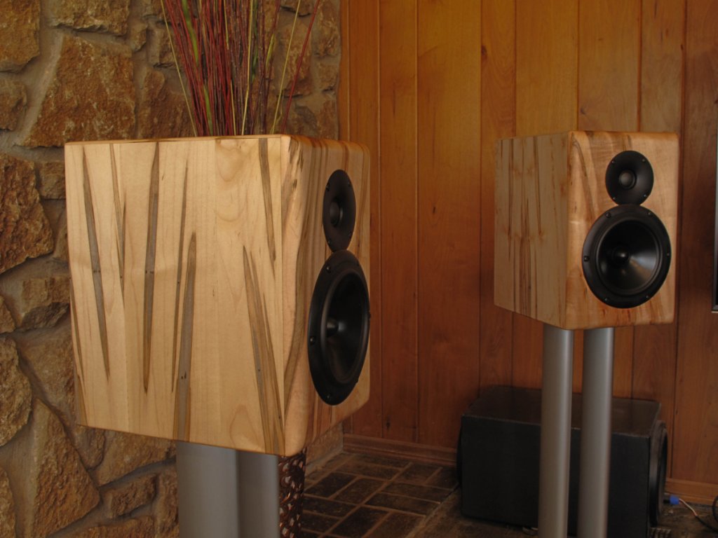

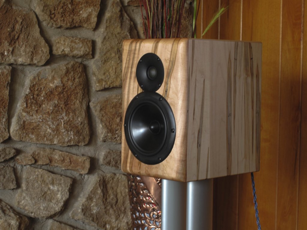

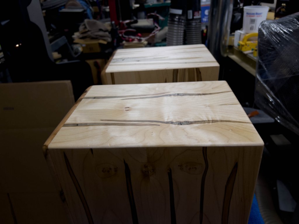

Michael wrote above: "These were a little more challenging than the last pair. For that pair the board I had was wide enough to get the top and side panels with one piece. With this pair, there were two boards. One was wide enough for the front and back panels be be one piece but the other was narrower so the panels were made up of two or three pieces. This meant gluing up wider panels after milling the pieces to 1/4” but that allowed me to play with the patterns. On some panels, book matching worked well while others required mixing and matching to get interesting patterns. With ambrosia maple, the patterns don’t always go all the way through the board which also made mixing and matching necessary."
This closeup shows his work book matching ambrosia maple.
We had too little time listening to this pair after the photo shoot and before it was back to business. X-LS Encores always elicit the "...ahh..." reaction from me. So smooth and warm at first listen unassuming then as one settles in you become aware of the wealth of musical detail on offer.
My DIY board, that hopefully will have a Christmas with us, if wifey is in the mood  :o we both have the flu…..
Merry to ya all and have a nice weekend.
Yes, the value of all the Miflex by-pass caps is the same.
