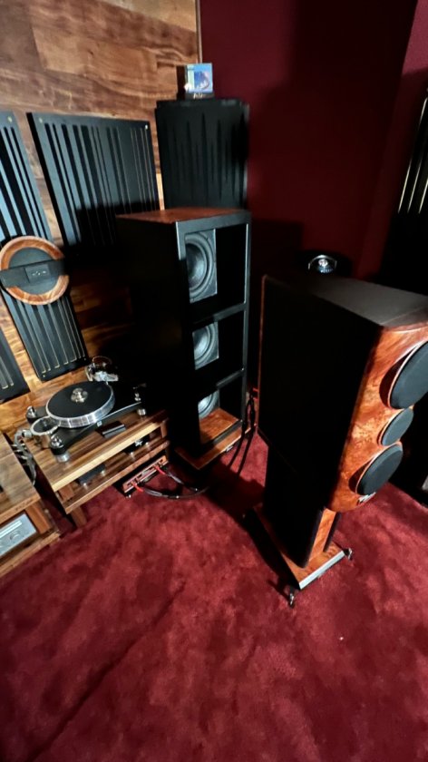

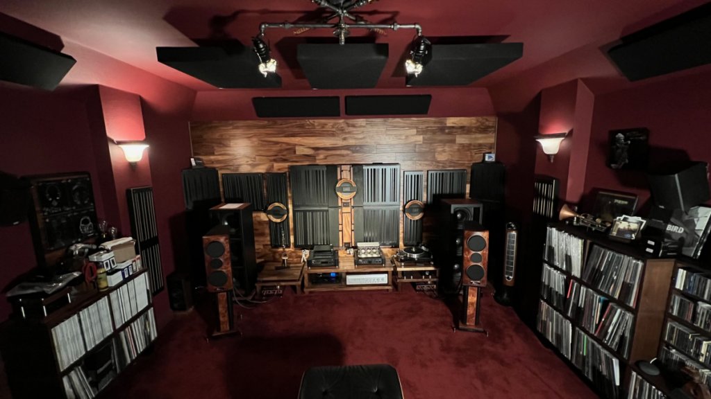

My name is Mike Goppert. I am a fellow DIY audiophile here in Frisco, Texas. I just bought a couple of triple threats over the holiday. I have attached some pictures of my listening room and speaker build. I'm trying to search this forum for break-in and setup hints, but I am unable to since I am a new user of AudioCircle (Kind of a strange requirement), so I apologize if these questions are already answered,
1. In my current speaker placement, I have a -10db dip around 50Hz. I tried correcting it using the PEQ, but noticed it only goes to +3db, Is there any other way to solve this dip other than trying to move the speakers?
2. How long do the drivers take to break in under moderate use (Hours)? I noticed the bass extension on very low frequencies is a bit subdued, I'm sure this is due to new drivers and the need for break-in. What do you guys use to break in these drivers?

Hey Mike, welcome to AC.
There is a lot that you can do still to flatten out the response.
First of all, work with your sub placement.
When measuring the room response be sure to only measure one channel at a time.
Take a picture of the settings on the sub amp and post it.
We'll get you tweaked to a flat response in no time.

OB subs are not like box subs.  Box subs do well placed near a wall but OB subs do not.  Pull them out away from the walls and place them close to the main speakers.

A 50Hz suck-out seems to be a typical issue in a lot of rooms. I've seen some report dips as much as -20dB!
You can't fix a suck-out (null, dip, etc, etc) with DSP or EQ. The only thing you can do is tweak either loudspeaker/subwoofer position, listening position, or both. Attempting to use DSP or EQ by adding 10+dB boost will do nothing but drive your gear, amps and drivers into clipping and distortion, and unnecessary stress as well as possible damage.
Other options are treating the room with more bass traps (all four corners from floor to ceiling if you can), or using more subwoofers located elsewhere in the room.
And yes, as far as your dipole subs are concerned, you need to have them pulled at least 3' from the front wall, if not more.
