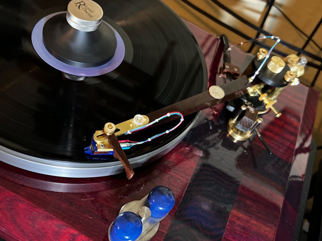

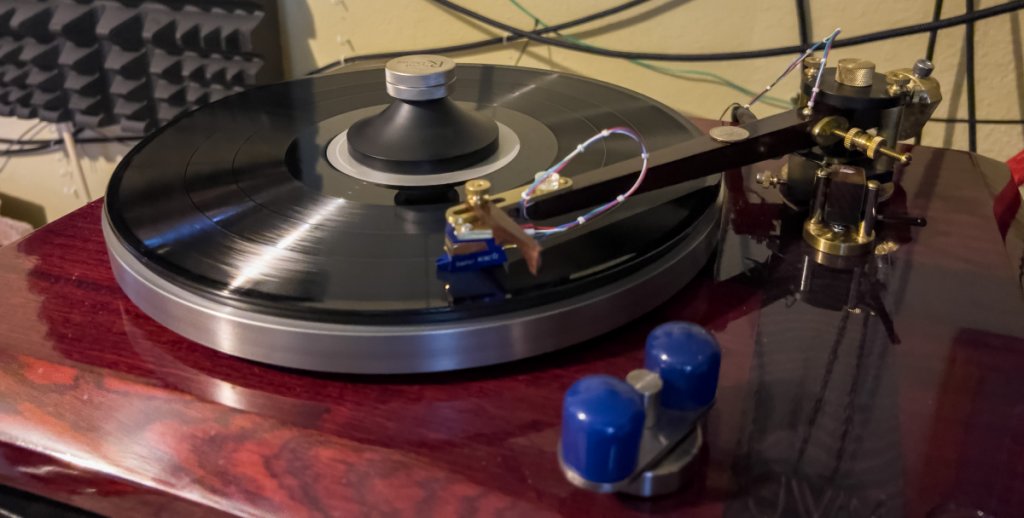

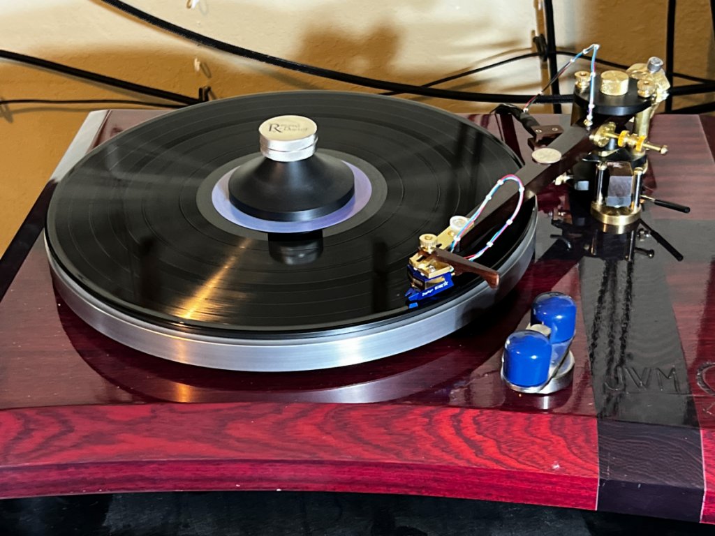

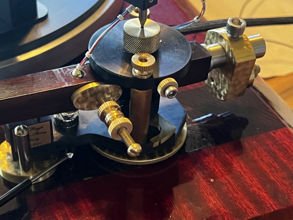

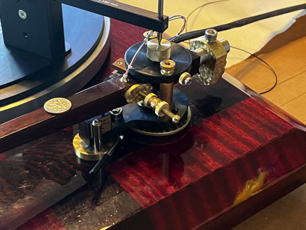

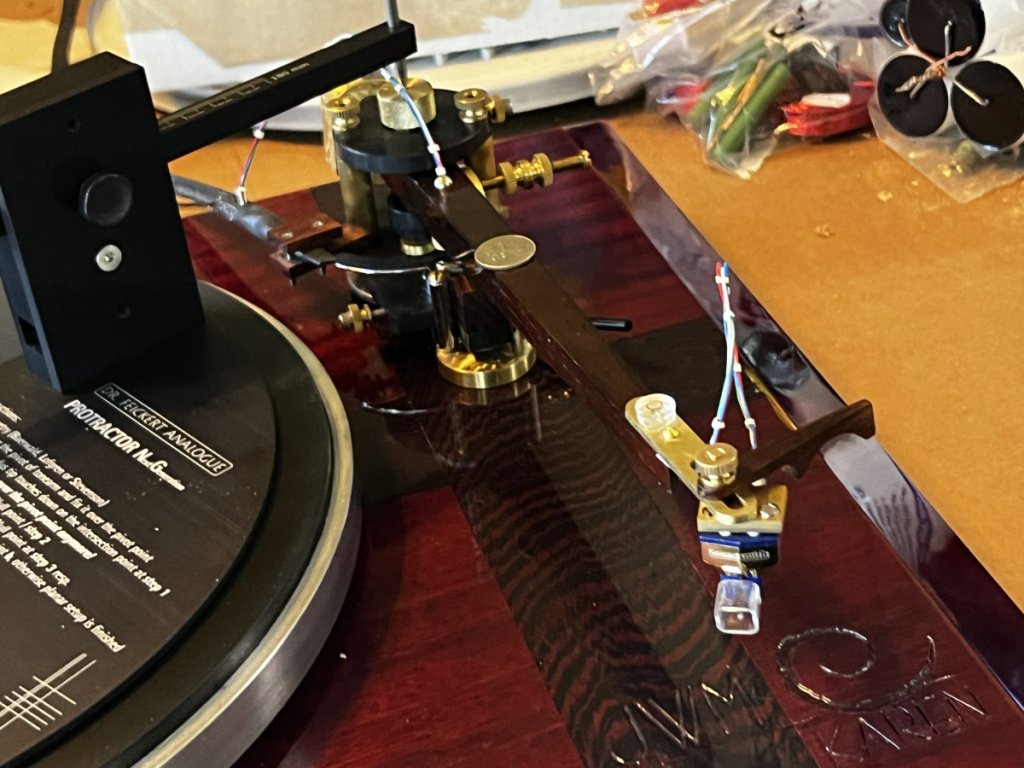

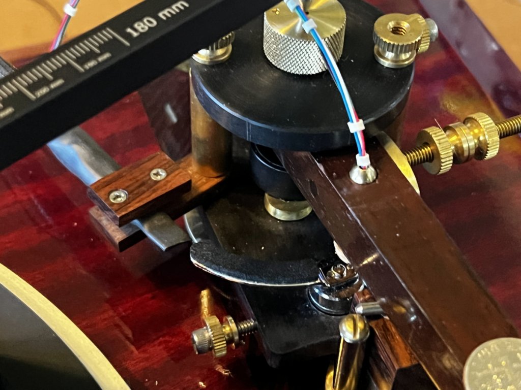

The turntable upgrades I started about a year and a half ago have reached a milestone. The new custom Woody tonearm from Pete Riggle http://www.vtaf.com/woody-tm-universaltm-tonearms.html#/  has arrived, been installed, setup, and is playing. Like the A370 amps, this tonearm is highly adjustable. Not difficult, just more steps / user input than you may be used to when setting up and dialing in a tonearm. Also like the A370s, the results are worth the time and effort.
The cartridge is a Soundsmith Zephyr MIMC Star https://www.sound-smith.com/cartridges/fixed-coil/zephyr-mimc-%E2%98%86
The new tonearm is on my JWM Acoustics Karen 6 turntable http://www.jwmacoustics.com/index-1#/karen
Here are some pics of the Woody being setup

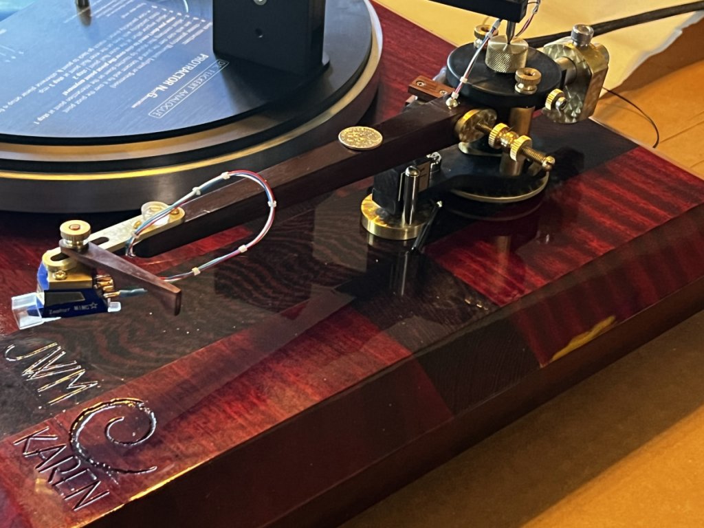

Here it is setup and playing
