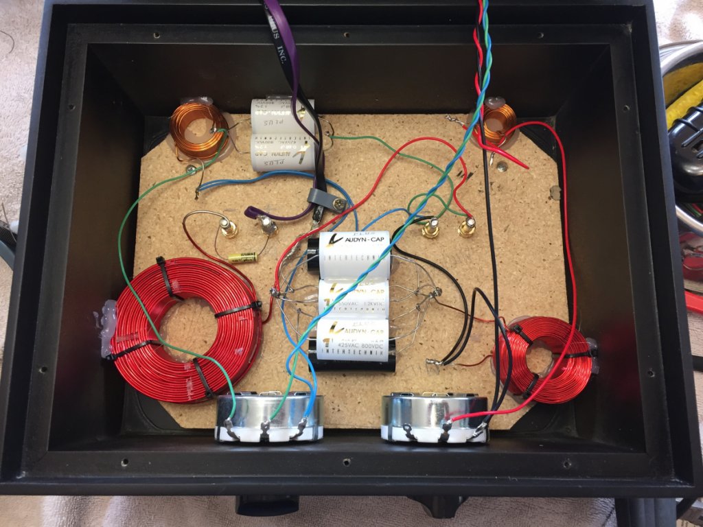

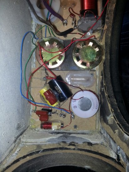

If you have the expertise to repair cabinets, the XO is a piece of cake. I have posted schematics of the RM-30's and Shaukat has posted RM-V60's. I just posted today the schematics on another post of the guy working on the tweeters of his RM-40s. The schematics are identical and everything is wired point to point, no circuit cards. If you decide to get these, I will provide the RM-40 schematic of the XO. I have a pair, but have never taken the time to draw up the schematic. The XO parts are not expensive and all readily available: 4 inductors, 3 sets of capacitors and two 8 ohm L-pads. L-pads are available from parts express for $16 each. We got you for the crossover. That said there will be nothing wrong with the capacitors so they can be reused, indcutors may have some corrosion (.25mH is $12, so its not going to break the bank) will not know until inspected, and just replace the L-pads. This is what the XO looks like except it is all inside the speaker, big 10" hole to get to everthing. One pic is also of XO inside speaker.
