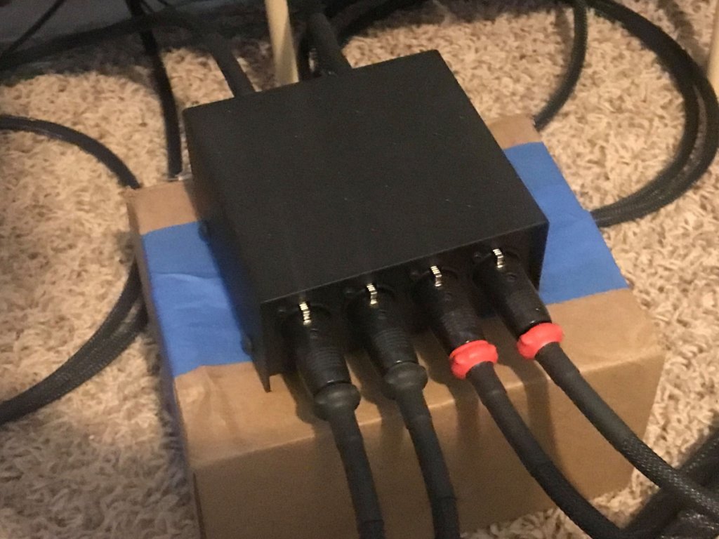

This is what I use. It is a splitter, and it works just fine. Since it's DIY you can use whatever connectors and wire you want. This one uses Furutech wire and XLR connectors. 2 in on one side and 4 out on the other.
RonP
  • Posts: 413
Re: Splitting XLR signal??
« Reply #4 on: 1 Mar 2022, 09:36 pm »
Thanks guys!

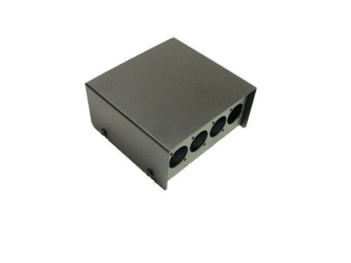

Mike, where can I get this case??
