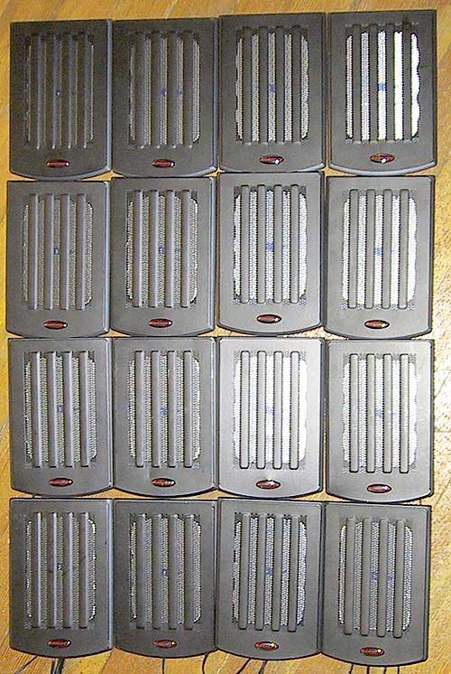

I'm very familiar with monsoon speakers, I have two pairs of the early panels with the wire frame, three sets of the planar 9 panels, and the FPF-1000's. I also bought 5 Planar 9 sets for my kids right around the time that monsoon went bust.
But I still don't get what this has to do with the low end of the tweeter.
obviously the mid panels can be crossed over lower. you could cross the upper frequency of them all the way down to 500hz if you wanted, although that of course would be useless.
But the low end of the tweeter needs to survive the extra bandwidth no matter what the frequency is.
I'm just trying to find out if it's safe to run them at 4k at full volume.
And it would also be nice if someone had the T/S specs for both the mids and the highs.

What does the exisitng XO look like?
My experience comes from 5 palletts of waranty returns after Monsoon was sold to Eastech. I went thru literally 100s of panels.
