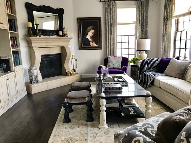

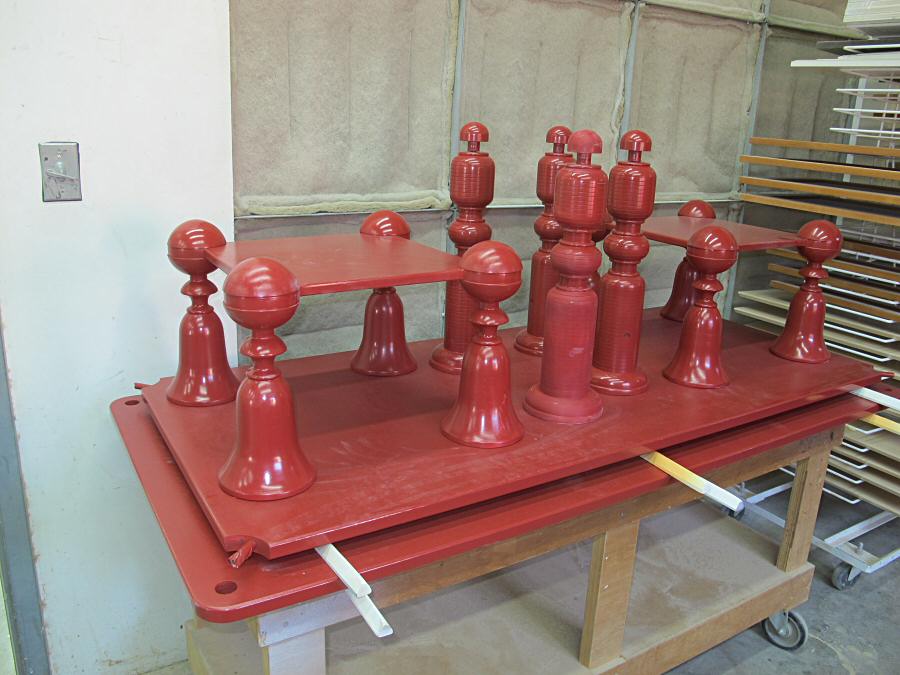

Colored primer on maple wood legs and combo-core plywood which has an MDF top and bottom and plywood center for a super smooth, flat surface.
Finished table and stools with color coat. The color is rubbed through to show red in places for a distressed look.
A clear coat of Kemvar Conversion Varnish added another layer of protection.
The black table top and shelf is flawless and looks like polished black granite but is lighter and cheaper. If we used granite I thought a 500 lb coffee table would be a little too much.
