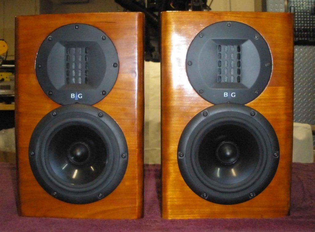

BG Neo 3 (PDR) with M130X = the N1X
Great sounding speaker. It's the one that got my wife to let me build the N3 transmission line that's in the living room which which led to the Wedgies then morphed into one build after another until I can't stop .......
I love the looks of those.  I am currently building some 3 way boxes with the BG tweeters and I have some of the GRS planar for testing.  I definitely like the sound of Planars and Ribbons much more than Dome Tweeters.  I might make a different box with the M130X's and the GRS Planar Tweeters.
