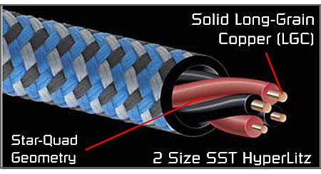

  I have attained great overall improvement with my 6 foot runs of Audioquest CV4 :thumb: This is the basic CV4.
« Last Edit: 20 Dec 2021, 03:45 am by redbook »
