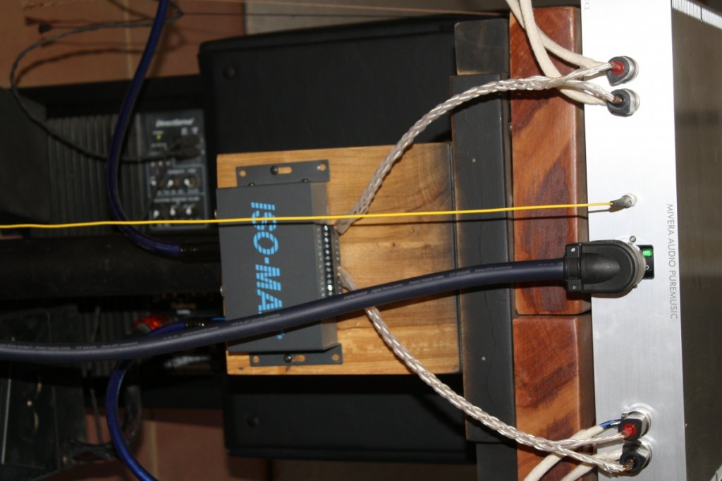

I use an Iso-Max to convert the high level amp output to low level RCA. It is suppose to be better to connect to the A370PEQ using the low level inputs than the high, or that was what I was told. You could check with Danny.
Heres my setup.
Vince in TX
  • Posts: 394
Heres my setup.
Heres my setup.
I also use a converter like this for both SS and tube equipment.....works well for almost 6 yrs now.
