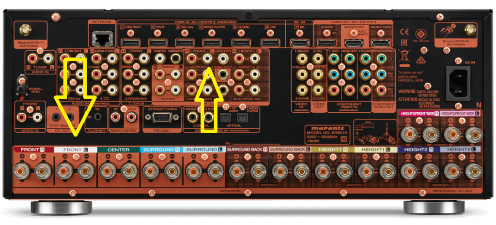

I was planning to use RCA on both ends of that speaker wire to convert it from a high-level output/input to a low-level pre-amp interconnect between the AVR at the back of the room and the Odyssey amp at the front of the room.   Alternatively, I could just put the Odyssey at the back of the room with the rest of the equipment and use short RCA interconnects between the AVR and the Odyssey.
...The preouts on your AVR are designed to be connected to a power amp or another preamp with an HT by-pass input which is then connected to a power amp. The power amp has the speaker binding posts which are connected to the high level inputs of the sub amps and to the speaker binding posts. This can either be done by connecting two pairs of wires to the power amp's binding post and running one pair to the speakers and the other pair to the sub amps or run one pair from the power amp to either the sub amp or the speakers and daisy chaining a second wire to the part not connected to the power amp.
This daisy-chain is exactly how it's hooked up now with the binding posts on the AVR going to the high-level on the sub amps, then daisy-chained to the X-Statics.
If you want to keep low frequencies from the amp powering the speakers you need an inline filter between the preamp and power amp. The filter needs two legs per channel. One leg has a cap that will limit the low frequencies going to the power amp and the other leg is a by-pass that sends a full range signal to the sub amp.
Any filter recommendations, links, or wiring diagrams?   I'm a visual thinker, so it's difficult for me to picture it.    :)
It's not the connectors that convert from a low level to a high level signal. The power amp does that. What you want to run from the AVR preamp out at the back of the room to the Odyssey amp at the front of the room is a well shielded RCA interconnect, not speaker wire. When I did this with single ended connections like you have, I used 25' Douglas Connections Bravo interconnects https://douglasconnection.com/product/douglas-connection-analog-interconnect-cables/  You have to contact Doug for lengths greater the 15'.

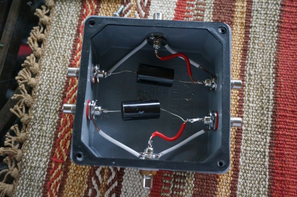

Here's a pic of one I built using an electrical box from a big box store, Cardas RCA chassis connectors, and Sonicap Platinum caps.
The legs going through the caps are the filtered legs. The input side is connected to the preamp and the output side to the power amp. The value of the cap depends on the input impedance of the power amp and the frequency of the rolloff.
The leg coming out the side of the box is the full signal by-pass leg which goes to the low level input of the sub amp.
Good stuff, thanks!
