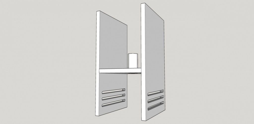

Rikard, here's an out-of-the-ordinary idea, although perhaps more work than it worth. But, of course, that's my specialty!
A quick render of bottom of cabinet
Dear Peter. My respect to you and your skills as you have shown in numerous YTvideos.  :thumb:I do see your creative touch to these speakers. Although it’s not WAF approved. :? The acoustics tells me to keep that rear port, period. :o But I want a down firing port, because of the look. Like Troel Graveson cabinet speaker designs. Imagine a speaker standing by it self in the room, so people can go around it, like a piece of art! :)
