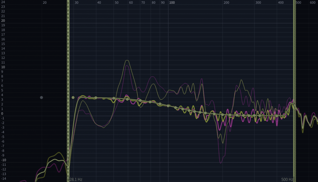

I'm posting images of Dirac's measurements / corrections for the subs and mains. Maybe somebody can enlighten me.

The first step would be to see if stereo sounds better with Dirac on or off with all digital processing disabled and/or using Analog Bypass. Do you have an analog source?

Dirac will always be messing with the sub signal, great for movies and video, not so good for stereo. For stereo I want the signal as unaltered as possible.
Even with the Dirac speaker setting to large the receiver may still be rolling off the bass to the Spatial M3 and sending modified bass to the subs. I don't know.
Can the NAD be set up with Dirac off for stereo and on for movies?
