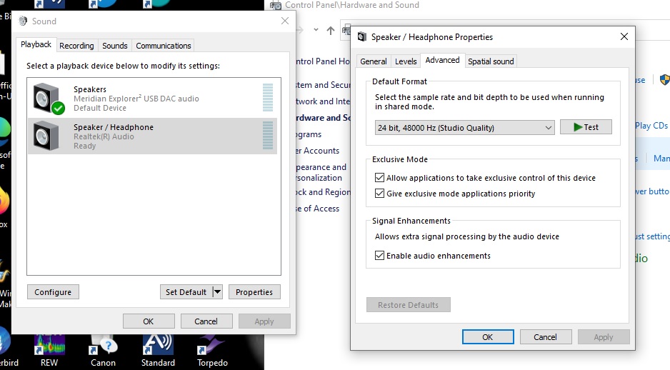

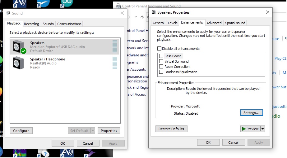

The Windows 10 settings for each DAC are different, so it depens on what the DAC mfg has provided.
If the driver has any signal processing advanced features, then that can add gain and then clip the signal.
Here are some examples of a Realtek and Meridian DAC settings under Sound. It really depends on the specific DAC mfg as to what they offer as Advanced Features. Windows10 also has surround sound settings for some DAC's if they are going to be used with headphones. Here are examples, but not related to your DAC.
