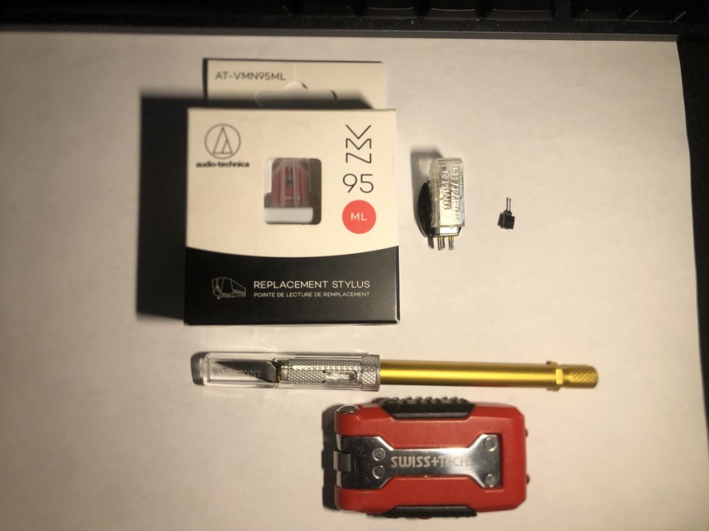

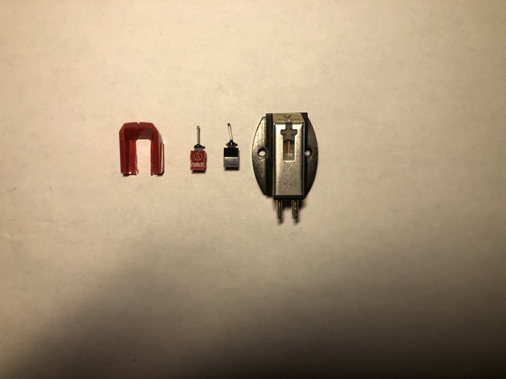

I thought I'd update this thread after having proceeded with this mission. I was able to successfully use the AT-VMN95ML as a replacement stylus for my Clearaudio Virtuoso wood.
Getting the bent stock stylus off of the cartridge was extremely easy, and using the exacto knife I was able to carefully cut out the replacement in about 25 minutes or so. Admittedly, the cutting was not the cleanest, but I don't particularly care, the turntable sounds excellent—better than stock dare I say. I want to say I'm hearing more space and detail in my recordings, but there could be a bit of confirmation bias working to that end. What I am very sure of, though, is that this new stylus is a lot more quiet with regard to surface noise; so even if it does equal the stock stylus in every other area, I think it enhances my listening experience with this alone.  :thumb:
